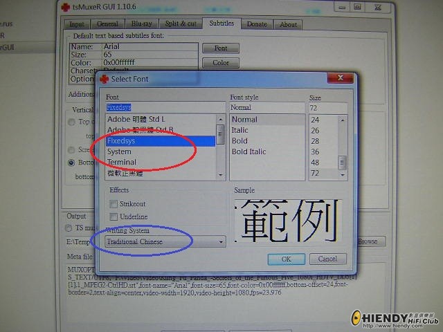

喺subtitile選項 --> select font選Traditional Chinese(藍圈), Font一定要選英文名嘅字體(紅圈), 如果唔係會出error, 建議用Fixedsys, 呢個字體較全面, size用番72就得

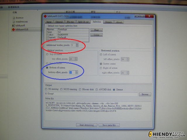

然後出番subtitle選項, additional border set做3(紅圈), 字體黑邊粗D, bottom offset set做26(藍圈), 呢個係距離畫面底嘅高度

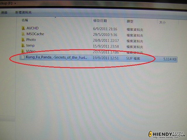

按start demuxing, 就會gen一條SUP檔出泥, 當然要記得save咗喺邊啦

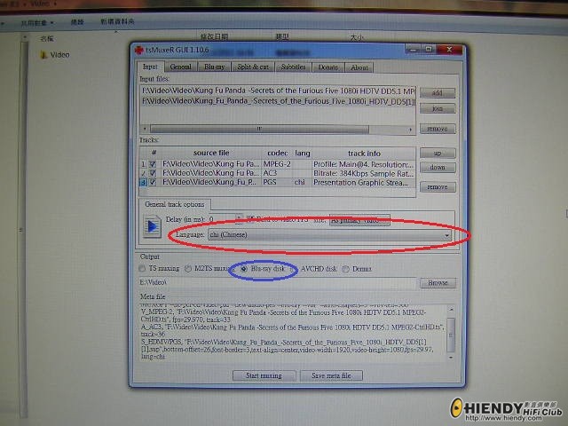

跟住再用TsMuxer, add條TS片同條字幕SUP檔入去, highlight個字幕, 喺language度俾番個名"Chinese"佢(紅圈), 然後選Blu-ray disk(藍圈)
按start muxing, 咁就會gen出播放穩定嘅BDMV folder出泥
