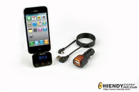

暫時你架車太新 , 等多一年左右會多返d對應到嘅產品 ! 你可以用住呢件野先 , 可以把iphone聲轉變去FM ! 甘你就可以係收音機收返相應頻率去聽返 ! 音質就一定一般架啦 ! 但係都叫做用到 ~
Digital FM/RDS Transmitter for iPod and iPhone with Included USB Car Charger
Possibly the most advanced FM modulator for the iPod and iPhone available, the iSimple JamKast iP uses patented dTect and PürSound technology to deliver the clearest playback possible, plus it displays song title and artist information on any radio featuring RDS.
Product Features Include:
•Compatible with any home or car FM radio
•Programmable tuner with easy-to-read backlit LED
•PürSound Technology delivers superior sound performance
•USB car charger keeps your iPod or iPhone ready to go
•“Now Playing” info displayed radios featuring RDS
