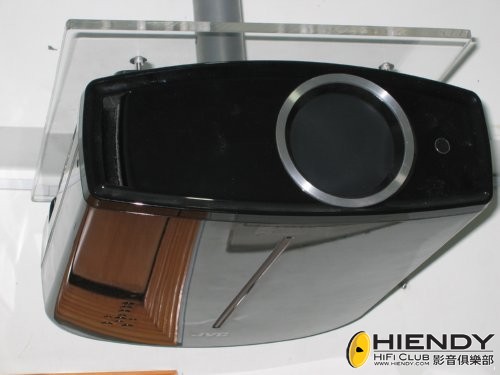

奇實塊亞加力要幾厚?
發表於 2013-2-2 09:56:15 | 顯示全部樓層
I would say at least an inch because of the weight.

本帖最後由 bmb_hd 於 2013-2-2 13:01 編輯
lamborghini436 發表於 2013-2-2 07:13
奇實塊亞加力要幾厚?
12mm 夠了!
我用12mm 掛350 八個月了 (供你參考),
沒有掉下來。
Acrylic for 350
Acrylic for 350
350 in place
350 in place

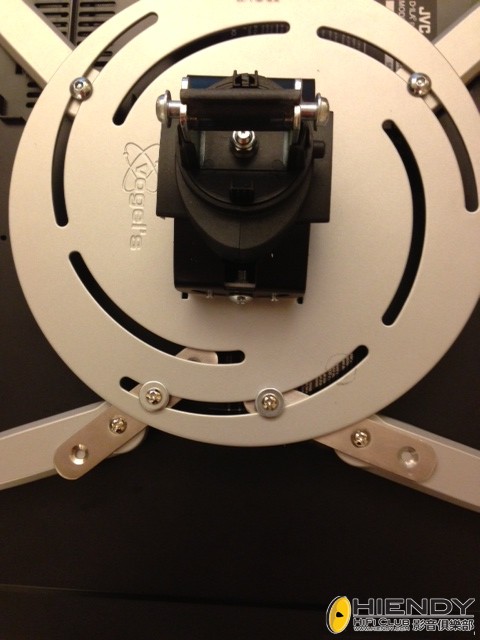

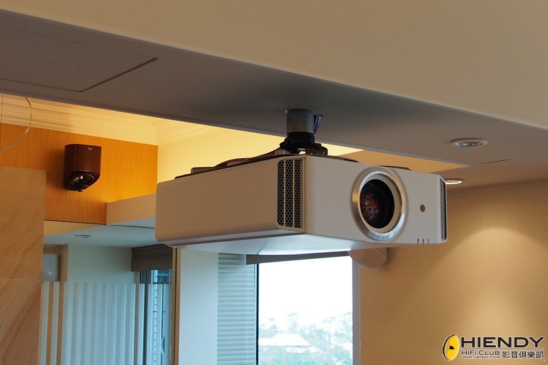

本帖最後由 stephenwan 於 2013-2-2 13:00 編輯
JVC X55R +  Vogels

bmb_hd 發表於 2013-2-2 12:48
12mm 夠了!
Nice work ching. However I think the X35/55 is almost 10 pounds heavier and depending on where you put the holes, say if you use the feets as mounting point, you might want a thicker one, just sharing.

本帖最後由 bmb_hd 於 2013-2-2 17:25 編輯
stephenwan 發表於 2013-2-2 12:54
JVC X55R +  Vogels
Ching, seems you have added some metal bars to make the mounting leg longer to fit the new bigger case of JVC PJ, am I correct?
If my guess is right then it is a much simply and cheaper way to make use of the old hanger. What a good idea!

breadvan 發表於 2013-2-2 16:46
Nice work ching. However I think the X35/55 is almost 10 pounds heavier and depending on where you ...
Of course thicker board can hold heavier load but at the same time it put more pressure for the old hanger which supposes to support max. 9kg only. Therefore I just set it at 12mm as compromise.
