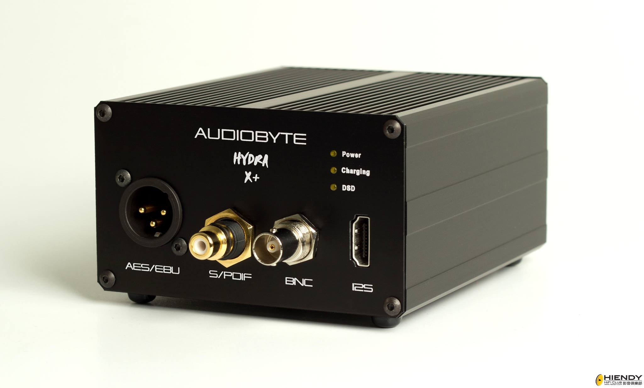

Hydra-X+ is released.

發表於 2014-2-6 07:10:57 | 顯示全部樓層
The placement of the connectors are completely different from Hydra-X.
I guess there is a completely new circuit board.
Any more details/info on this new Hydra-X Plus version or internal photos?
Thanks!
發表於 2014-2-6 12:37:35 | 顯示全部樓層
CKKeung 發表於 2014-2-6 07:10
I guess there is a complete ...
Yes, it is a new board with refined circuit and improved battery power management.  As many customers asked for coaxial SPDIF which is known to be better than RCA connector, so this new version has both SPDIF and RCA connectors.   Toslink optical connector is removed to give room for coaxial.
I2S (HD-Link) is now vertical instead of horizontal.  It is more firm and stable this way considering the weight of some HDMI cables.
I have installed it yesterday driving the newly received Rockna Audio WaveDream DAC (using MSB DAC module).  Working pretty well.  Going thru run-in now.
