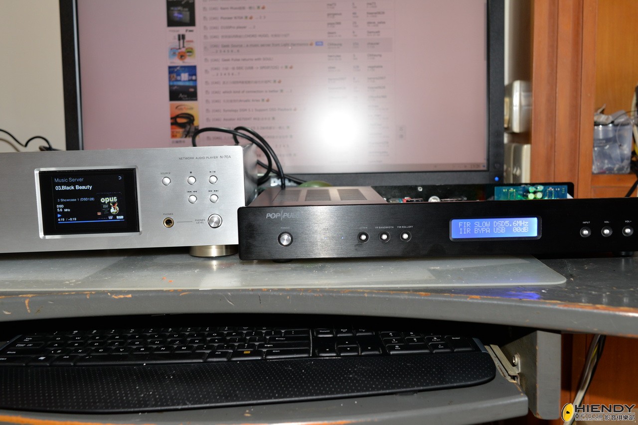

本帖最後由 steveha 於 2014-11-29 13:58 編輯
Unbelievable .  I have successfully add I2S-HDMI output into my N-70A.
Both PCM and DSD signals are natively transmitted to the dac.
On the dac side,  I have replaced the Amanero USB with a HDMI-I2S receiver card.
The most interesting part is that DSD_ON was extracted from N-70A and being buffered to the DAC via HDMI cable.

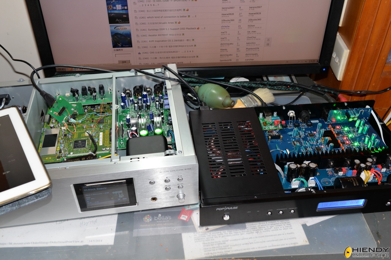

發表於 2014-11-29 13:50:27 | 顯示全部樓層
本帖最後由 steveha 於 2014-11-29 13:57 編輯
They are signing right now !!!

發表於 2014-12-2 08:19:36 | 顯示全部樓層
嘩!全部除晒衫
發表於 2014-12-2 12:51:39 | 顯示全部樓層
本帖最後由 steveha 於 2014-12-2 12:59 編輯
可以著番衫.  In summary, I installed an I2S Send Card with buffered DSD_ON and patched 6 wires from the N70's controller board.  The N-70A's dac can be shutdown by removing its power connector. Now, my N-70A became a Native I2S music player supporting both PCM/DSD via HDMI LVDS.

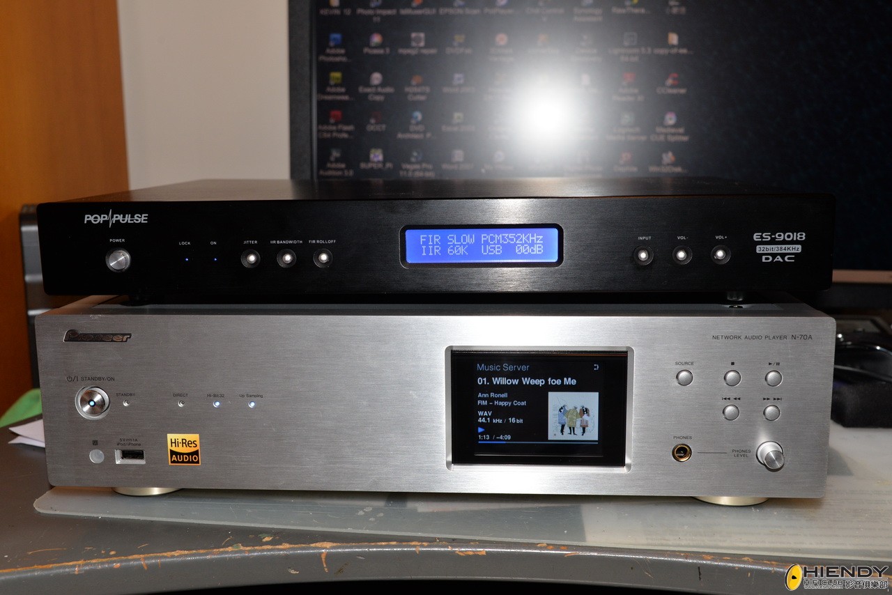

本帖最後由 steveha 於 2014-12-3 18:25 編輯
Sorry. I don't have the skills and time to provide mod service.
BTW, just test the Up Sampling of N-70A.  The results are very acceptable.
44.1KHz will be up-sampled to 352KHz and 48KHz family will be 384KHz.
So far, I have tested N-70A with POPPULSE (twin ES9018), Buffalo III (Single ES9018), TDA1541A, PCM1704 and AD1865. Surprisingly,  NOS AD1865 can support PCM up to 384KHz.
