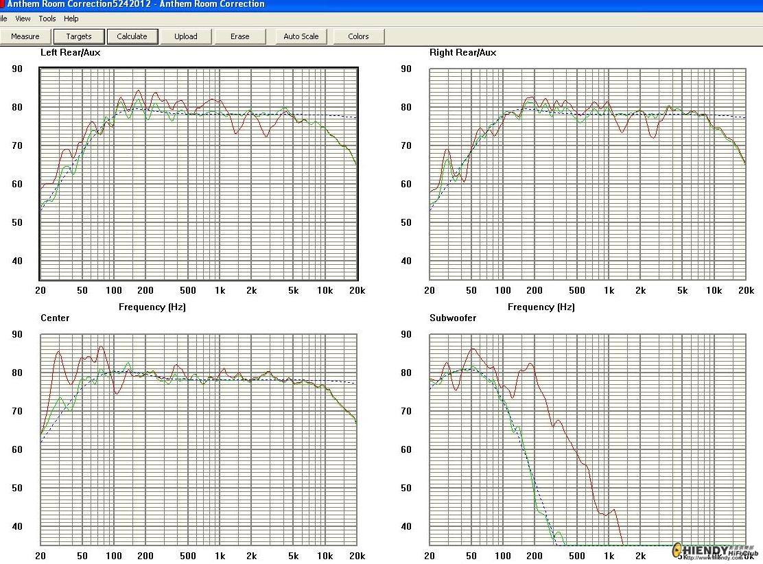

I keep studying on how to improve my calibrated charts especially on SUBWOOFER (see the pict), I am not happy with how it looks at all.  AVSforum mentioned we should aim for the auto calibration result for a 120hz cutoff for SUB, if you can't achieve this, you better move your sub location, otherwise you will miss some very good punch.  I am planning to do that, painfully.
不是set個crossover to 120hz啊,記住!

Very impressive, your sub curve looks already very nice to me. May I ask which subWoofer are you using and the spec(frequency response)? Which part of your sub you think needs improvement-  puch, atmosphere,surrounding-feel or lower frequency extension? Sure moving your sub position might be helpful to locate the best position using Quick Measure.  I tried it once before but maybe there was little space for my sub to move around I did not see much change in the charts. Please report back/share findings/results in due course,3q.

Its a VELODYNE DD15, I posted in 同好會 as well.   puch, atmosphere,surrounding-feel or lower frequency extension all seems well, but if you look at the SUB chart, it rolls off after 50hz and severely dip at 120hz, therefore ARC set it to 80hz for me, which is not ideal.  I guess I can get more punch if the chart be flat till 100hz and cutoff being assigned to 120hz, the bass will blend more into the main speakers.

I think someone in AVS forum once mentioned(not sure about that ) that it is actually "roll-off" and not "cut-off"

ARC sets at 80hz -->roll-off only, which  means starts to decrease  sound level pressure gradually whereas cut-off means complete no output below/above (as the case may be) that specific frequency.
