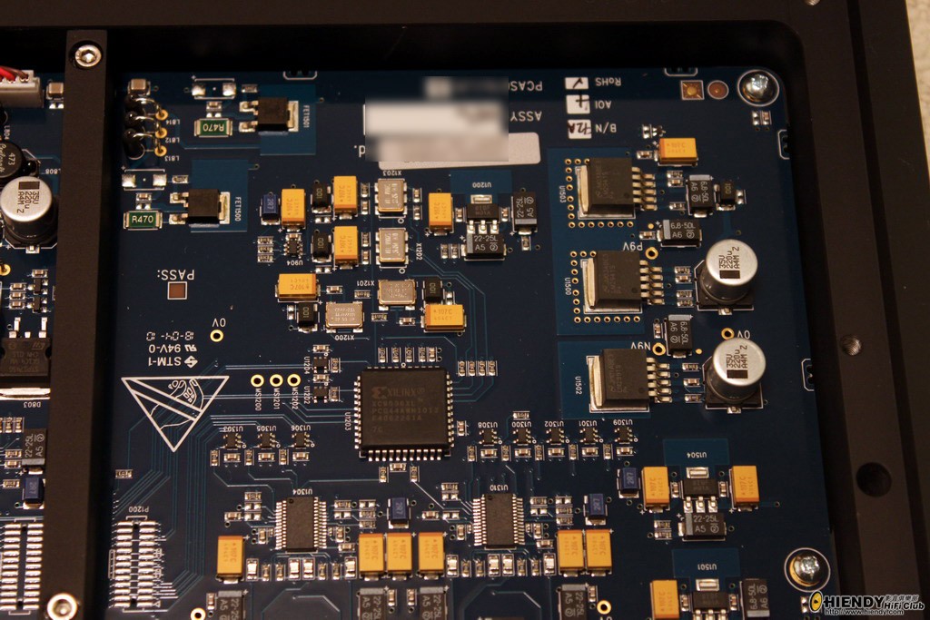

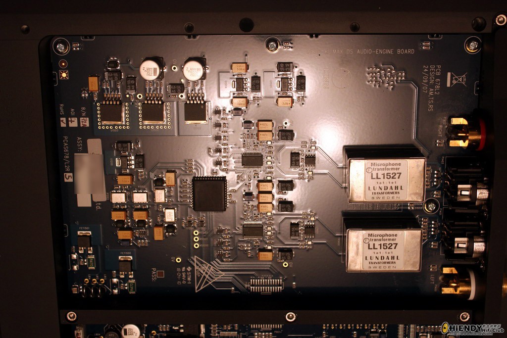

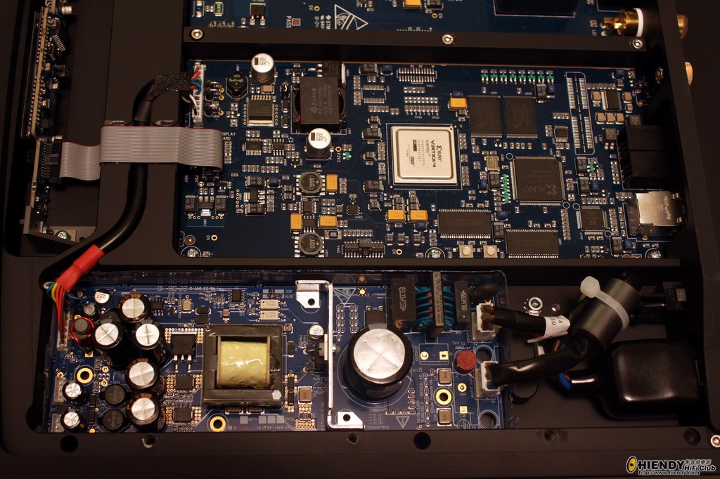

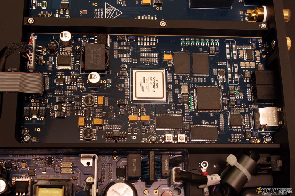

Not totally agree.  From engineering point of view, LINN DS circuit is indeed quite advanced.
Linn uses all surface mount components to achieve fast and low noise power delivery; it is more advanced than traditional through-hole circuit.   Traditional circuit is not suitable for high speed circuit because of long part legs.
Linn uses lot of local power regulations.   Three next to the signal processor, another two next to dac section.   The main one seems quite sophisticated too.   With so many local power regulators, the main power is switchmode isn’t really relevant.
All capacitors are tantatum type (brown color) and some expensive polymer caps (black color) around key components.   These polymer cap makes Blackgate like stone age parts!

Once use surface mount, it is not easy to tell the part quality and cost.   Film cap by Wima or Epcos look almost indistinguishable from cheap stuffs.
Attached picture is Wima SMT cap.
Why some highend manufacturers still use traditional red box Wima cap and like even through they know surface mount is much better for high speed application?    Because audiophiles all like big parts.   Big parts look more valuable to them.   Those manufacturers choose to use big and colourful parts by their eyes rather by their heart & brain.

Can you conclude that SMD is better than traditional electronic component due to shorter signal path, lower distortion and higher speed?

Better to phase it as "SMD is better suited for for high speed application than traditional circuit."
And depends on speed requirement, traditional circuit may or may not be able to meet the speed requirement.
Some traditional circuits use partial SMD to achieve speed requirement for particular part of the circuit.   e.g. SMD around processor only.
Modern audio devices use high oversampling and complicate digital processing, speed requirement will become higher and higher.

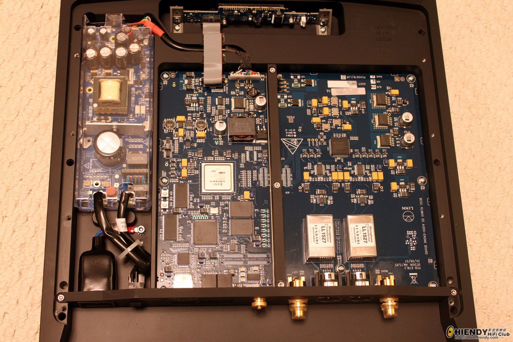

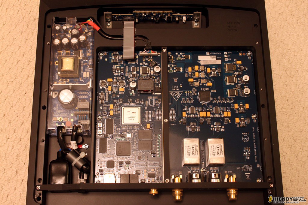

Glad to have m40 hing to provide some in-depth reasonable technical information for us to learn.
I can share the internal photos of my Klimax DS.

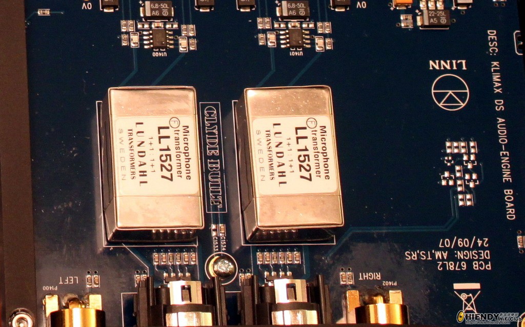

回復 95# raywan
    有隻名貴輸出牛!!!

    有隻名貴輸出牛!!!
三文魚腩 發表於 2011-5-7 10:53
Linn Akurate DS
Linn Klimax DS
發表於 2011-5-7 19:01:45 | 顯示全部樓層
Linn Akurate DS
Linn Klimax DS
raywan 發表於 2011-5-7 12:27
舊式機以名牛輸出﹐聲音帶甜﹐人聲表現非常好﹐秒殺卡式磁帶機。
