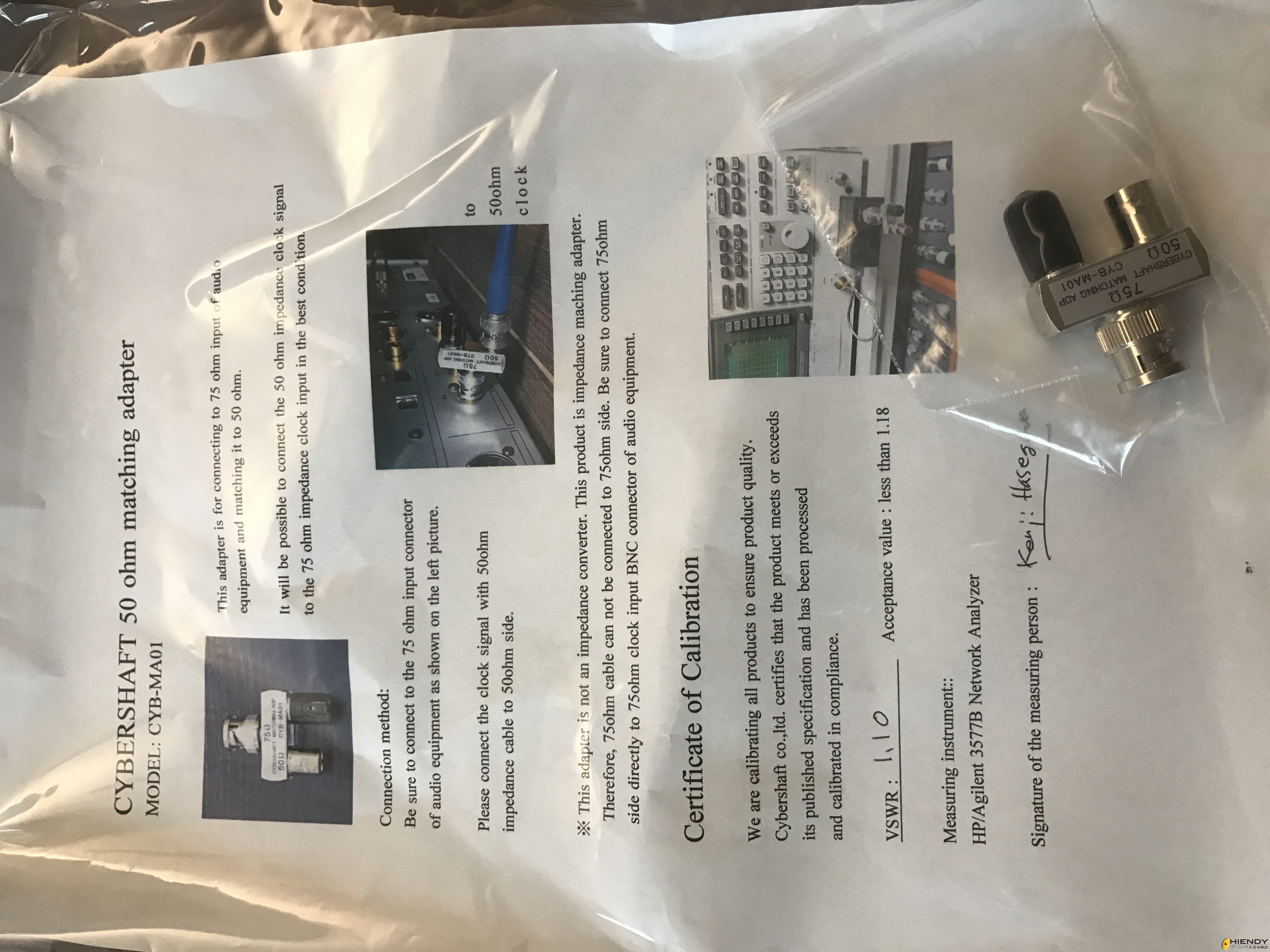

非常感謝Audiophilelp兄解答,原來C1要加個50ohm 阻抗轉換器先可以用到Cybershaft 鐘
唔知對聲音有無負面影響?
不過估唔到連而家條75ohm BNC都要廢埋武功,50ohm BNC 好似無咩選擇= =
 樓主| 發表於 2017-6-10 22:47:31 | 顯示全部樓層
r002 發表於 2017-6-10 21:52
唔知對聲音有無負面影 ...
應該會有絲毫影響,始終個clock喺50ohm, 但C1只有75ohm同hi-z
High-z應該是300ohm,所以要terminator
最ideal當然是用75ohm output clock或者⋯⋯⋯⋯
用返CH T1囉
其實我都係一知半解,我都係一頭霧水
請高手解答一下

用返cybershaft 條clock cable, 千幾yen而已

用50 ohm嘅係reference clock,75 ohm嘅係master clock,其實係唔同嘅嘢嚟......

簡單講,用條impedence唔啱嘅bnc線傳clock signals,有啲顧此失彼,聽多咗線嘅音色,但破壞晒外加鐘嘅原意。有人覺得「耳聽為實」過到對耳就ok,但我覺得有可能係得不償失。

i am using the original cable and clock cable too, after comparing a several clock cable.
the original one give the best real sound. and please try set it to 75 ohm. i used high Z before, but after 6 months of listening, 75ohm gives the best real sound.
I tried the adaptor suggested by cypershaft. please don't use it. in my case, really bad sound.
one more setting might reduce the "offline issues", it still happen but it reduces the number of time.
I tried to set the network setting to slave in C1, thanks to a ching suggestion. of course, i don't know what does it works but it somehow reduces the number of time of offline.
btw, i am using NAS streaming only at C1.

Do you mean using 50ohm clock cable and connect to c1 as 75ohm?

Correct!
Using his original clock cable.
Other clock cable that I tried were 75ohm

跟隨CH precision廠指示, 入埋150ohm resistor, 以75ohm入c1一
