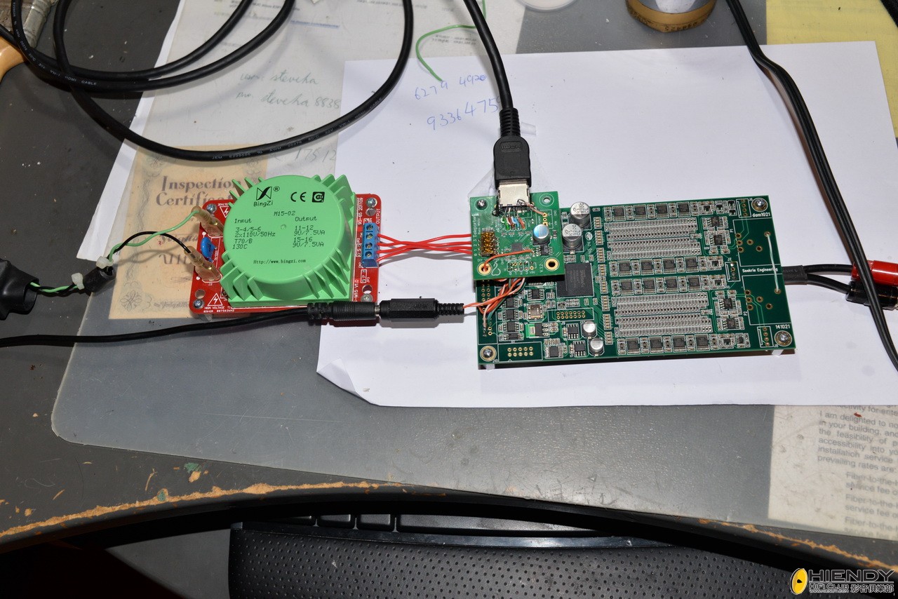

發表於 2015-2-3 21:02:46 | 顯示全部樓層

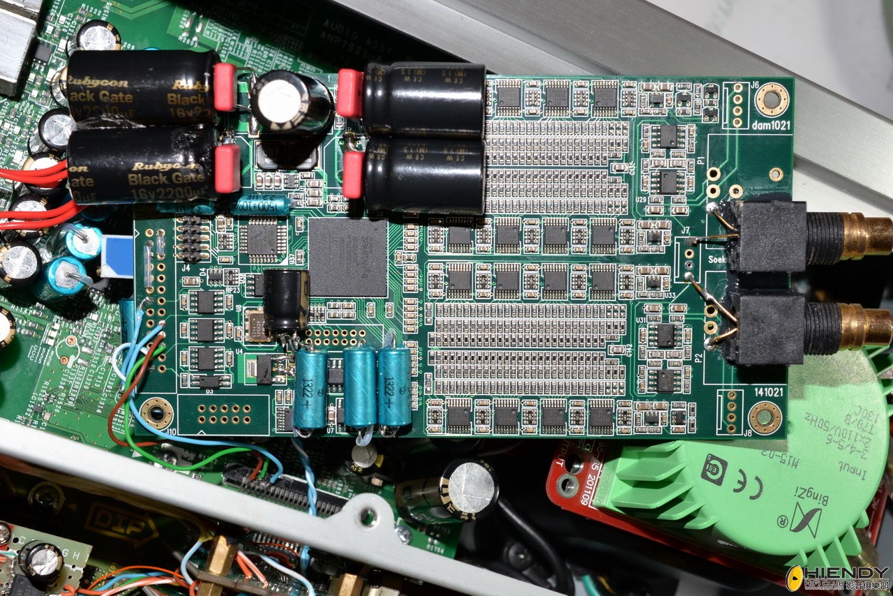

本帖最後由 steveha 於 2015-2-10 00:21 編輯
Just received the DAC today and already made it running (supported all sampling frequency up to 384KHZ).
Not difficult to install.   I am testing it with HDMI-I2S using Beaglebone Black.
All you need are to connect :
1) power supply - 2 x AC 7-9V (4 wires) and  DC 3.3V / Ground (2 wires)
2) I2S (3 wires)
3) RCA RAW out or Buffered SE Out
發表於 2015-2-5 12:39:03 | 顯示全部樓層
本帖最後由 steveha 於 2015-2-5 12:45 編輯
Somemore testings were done using N70A's HDMI I2S.  It seems everything were just fine including  Media Server, Amanero USB. I2S input and Upsampling.  The only complaint is the default volume was set a little bit low so I need to add a 2K potentiometer to increase the digital volume. Also, I have disabled the autodetect of input sources and the only input became I2S.  Tonight, I will move them into the my N70A.

本帖最後由 steveha 於 2015-2-5 18:10 編輯
casshan ching
First of all, you need an electronic selector (e.g. TPA OTTO II or even a single chip FST3257G) to switch between two I2S sources.
On N70A,  the USB CM6632A chipset will not be powered on (i.e. by a 3.3v) when you started the player.  It is only powered on when you select USB DAC.  As a result, that 3.3v can be used as a trigger to switch to I2S lines of Amanero USB.
In my setup, the DAC's I2S is connected to the N70A's controller board by default.  However,  when 'USB DAC' is selected the DAC's I2S is switched to the Amanero's I2S lines.  When you select other functions like music player, that 3.3v will be shutdown and the connections will resume back to N70A's controller board.
I2S lines consists 4 wires (instead of 3)  namely : BCLK, FSCLK, DATA and DSD_ON.
Hope this help.
發表於 2015-2-5 22:27:48 | 顯示全部樓層
本帖最後由 steveha 於 2015-2-5 22:28 編輯
話咁快就已經將份R2R dac 放落部N70A.  It has its own power transformer and the audio out of R2R and ESS9016 were enabled at the same time.

發表於 2015-2-6 17:29:19 | 顯示全部樓層
本帖最後由 steveha 於 2015-2-6 17:36 編輯
其實唔喺好複雜
我覺得R-2R 把聲非常準確, 不過有D清淡. 可能D resistors 要run-in.
而家加番幾粒Vishay Military Tant 好味好多.
令晚試吓摩其他Cap.
發表於 2015-2-6 22:12:13 | 顯示全部樓層
收功. Black Gate 行頭, Vishay Tant行尾.
又去了另一Level.

steveha ching,
in soekris manual, it said +/-7~15 VDC, but u say 3.3 VDC 2 wires ?  u mean 3.3v dc to j1
發表於 2015-2-8 00:47:32 | 顯示全部樓層
本帖最後由 steveha 於 2015-2-8 00:53 編輯
As I am using I2S, 3.3V is for the dirty side of ISOLATOR (i.e. ISO +3.3v and ISO GND).

steveha hing,
我見你綠色牛牛output 是9v AC, so far 用落冇問題?因板主話 2x7~8VAC input. 我找不到7~8VAC 牛牛
發表於 2015-2-10 23:11:38 | 顯示全部樓層
無問題,暫時用住先.
不過已買了7.5VAC.
http://www.ebay.com.hk/itm/12129 ... d=p3984.m1423.l2649
收到後換番.
