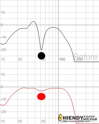

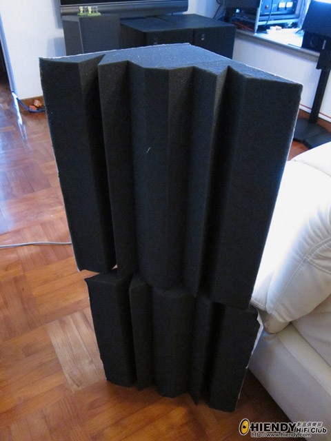

用左bass trap後
除左聽感有分別
原來數據上都係有分別
張圖係今朝新cal, 但舊果張唔見左
不過大約都記得係邊
舊既大約係黑點及紅點位
<未有bass trap前>
50Hz差唔多係消失左
我個聆聽空間同sub仔實在太差了
cal完 50Hz也欠起碼7-8個db
<上左兩個bass trap後>
未cal前都欠20個db
cal完只係小左3-4db
而家d bass實淨左, 小左wowo聲
happy

 樓主| 發表於 2011-5-1 16:34:15 | 顯示全部樓層
I see
According to my experience with the software of SVS AS-EQ1, the information is quite rough. ...
raywan 發表於 2011-5-1 16:25
thanks, I'll try it later

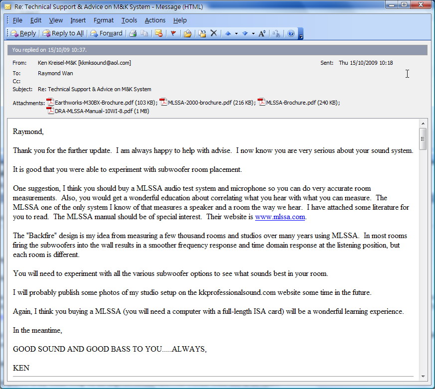

(4) MLSSA --> US$2,750 (Ken Kreisel 建議我去買)
