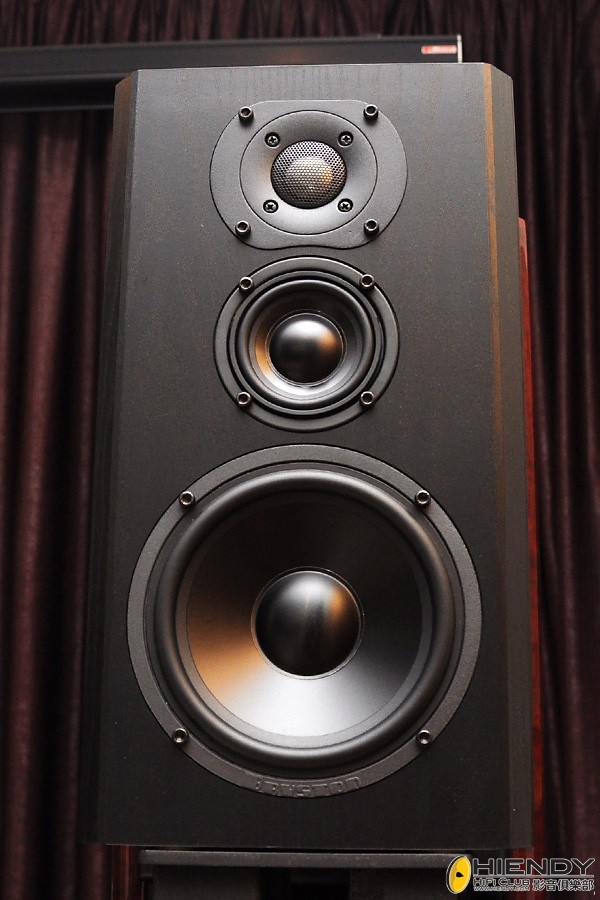

I have to say that among the small loudspeakers I have tested so far, these Brystons offer the best in terms of material value. They come in a bigger size compared to the other mini monitors and are 3-way loudspeakers instead of the 2-way that are common at the entry level. Being a 3-way also means that they are more challenging to design. The designer has to take greater care in order to achieve a seamless integration of the frequency bands among the 3 drivers. It is gratifying to know that Bryston was willing to go the extra mile to bring greater value to its customers.

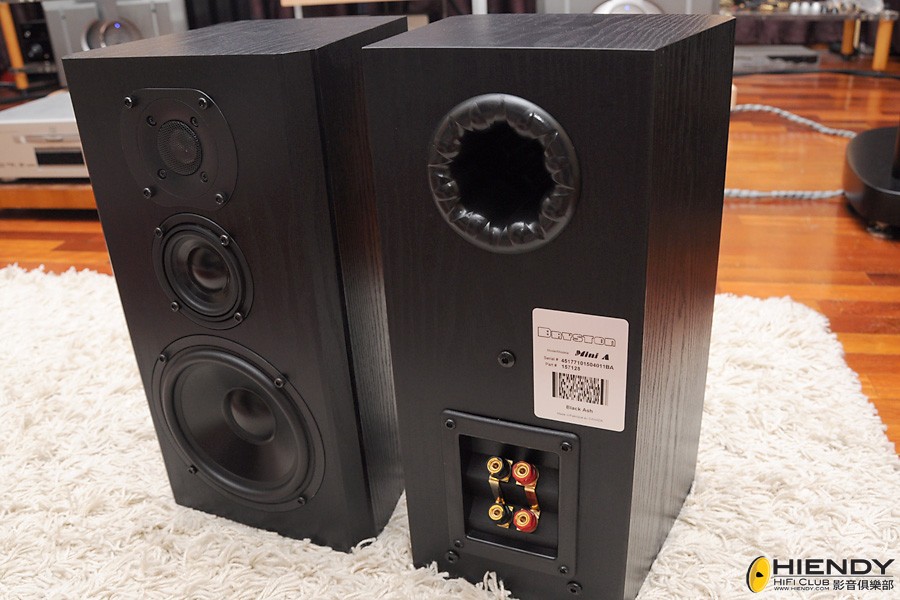

The Bryston Mini A comes with a 1’’ tweeter, a 3’ midrange driver and a 6.5” bass driver. The frequency response is quoted as 60Hz-20kHz (+-3db), sensitivity of 87db/w/m and impedance of 8 ohms. Bryston also says that they are capable of max 100dB at 1 m. The Mini A’s dimensions are 15.5” H x 8.5” W x 8.25” D (394mm H x 215mm W x 210mm D) and each speaker weighs 11lbs (5kg). It is a bass reflex design with the port situated at the back of the loudspeaker. The port has an irregular finish aimed at eliminating turbulence and air flow noise.
The Mini A comes in a few standard vinyl finishes, the units I collected from Bryston’s local distributor, AV Designs, are of the Black Ash variety (the other finishes are natural cherry and Bostom cherry). The box design is not the normal rectangular shape, but it is not the curved side, boat shaped ones more commonly seen nowadays either. It is a trapezium, with the front panel, containing the drivers, wider than the back.
