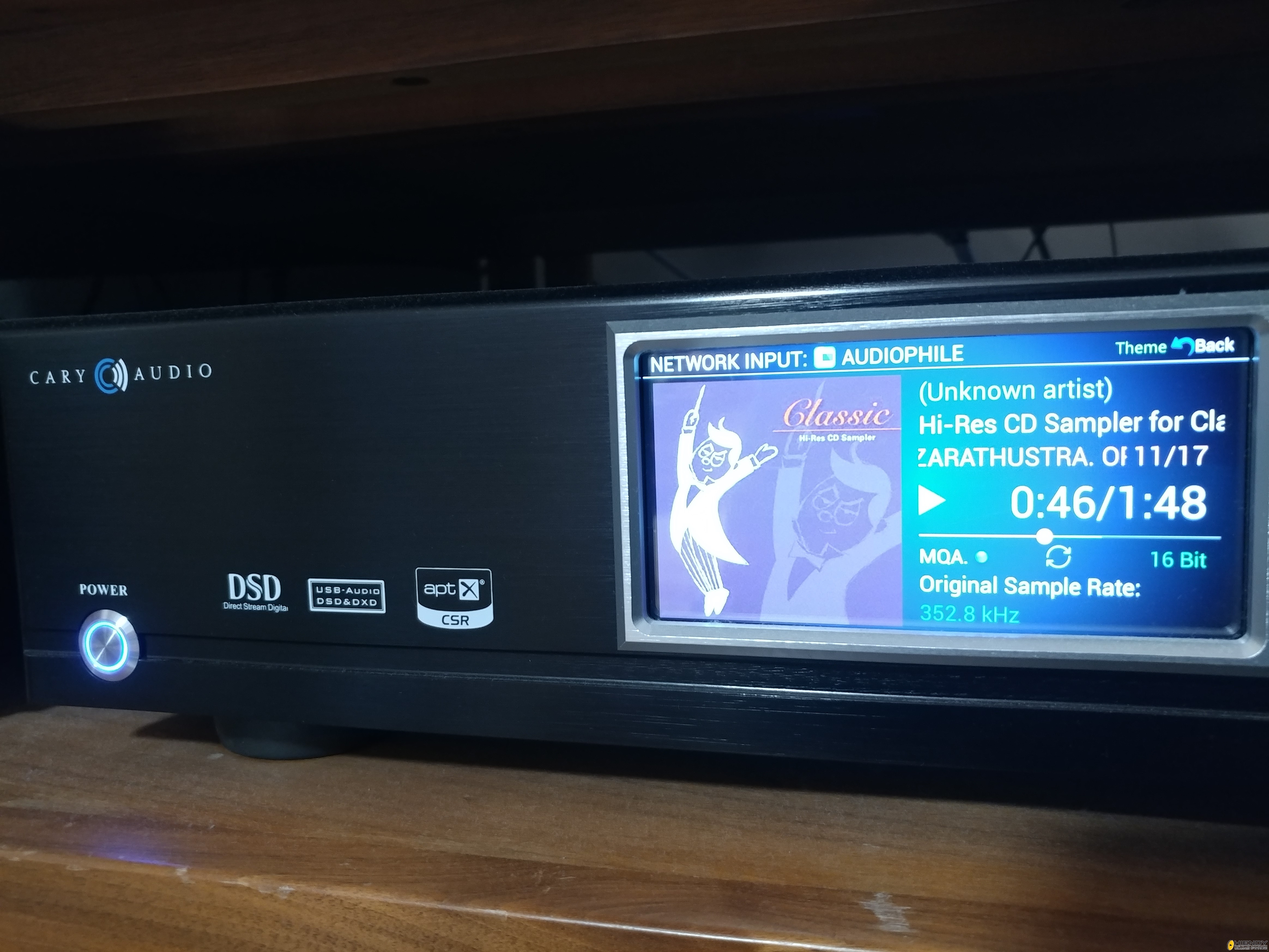

日本剛剛出了新的一批UHQ MQA-CD,好奇之下買了一張sampler回來試試。Ripping 後成功在cary dsm500認出並正常播放到MQA files.

係呀,我只是用dp poweramp照做ripping as flac
 樓主| 發表於 2018-6-22 18:19:17 | 顯示全部樓層
clausewitz 發表於 2018-6-22 13:00
究竟怎樣ripped? 而且CD player怎樣讀到MQA? 我一直好有疑問
Clausewitz兄,
我只是跟普通CD照rip,看來只要device 是mqa support,便可認出MQA Files
道理我也不甚明白。

發表於 2018-6-22 23:43:16 | 顯示全部樓層
這問题比較複雜……
mqa cd 的音源是來自universal jp 的 shm sacd (dsd64) ……
而這dsd64 據說 是母帶經各不同途徑(英、德、美、日)做remaster……
將dsd64 轉為 24/352 , 再壓缩做 16/44 cd
母帶 -> dsd64 -> 24/352 -> 16/44
若用mqa decoder 放大播放
16/44 -> 24/352
但也有個別碟是24/192或24/176……
大概各種format都有過冷河式參與
 樓主| 發表於 2018-6-23 00:45:51 | 顯示全部樓層

What do you need to play them?
An MQA CD is a Red Book CD and is 100% compatible with any existing CD player. The audio on the disc is MQA-encoded PCM, and will play back happily without a decoder. In this case, the sound quality is slightly better than a typical CD, because the audio is already de-blurred in the studio. However. if the bitstream is passed to an MQA decoder, it is unfolded to 176kHz (in this case) and rendered to the DAC at 24-bit.
Besides the Meridian player equipped with MQA, can anyone connect a CD transport to an MQA-enabled DAC, perhaps from another company, and decode the MQA.

MQACD裡面嘅MQA係將Hi-res音源壓縮成16/44.1
原理係用運算法將超越nyquist theorem容限(44.1kHz極限係22.05kHz)嘅訊號壓縮去noise floor之下,然後支援MQA嘅DAC會硬解將取樣率提高推低個Noise floor,然後再dither下
基本上因為完全係利用運算法嘅還原法,所以MQA係有損壓縮,其實同以前嘅HDCD差唔多,只係MQA可以壓縮到24bit做16bit,而HDCD就20bit去16bit
Wiki有講MQA因為會佔用Least Significant Bit同佢之前1bit去記錄壓縮咗嘅數據,呢個係點解MQA唔用硬解到嘅DAC去播音質會差過普通CD嘅原因,因為實際數據係頭14bit,而講音質嘅話,因為所有upsampling同dither嘅模式完全依賴嗰兩bit,所以係取代唔到真正hi-res檔
