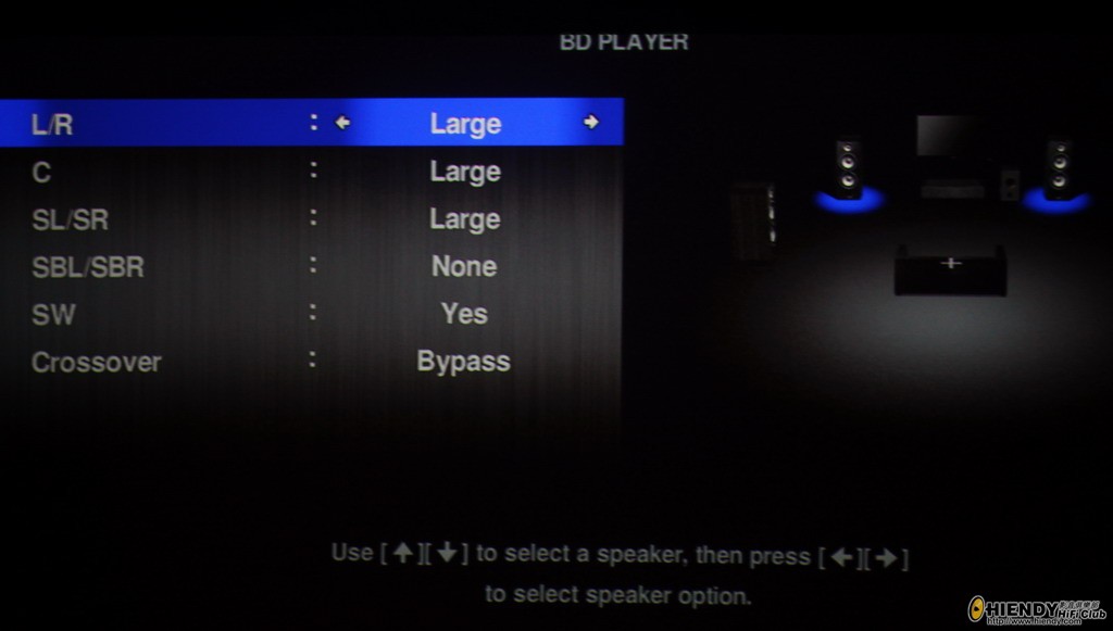

我用Pioneer 09FD analog out 去 Krell HTS 7.1前級, 所以crossover要係Pioneer 09FD度set, 不過個subwoofer pink noise就好奇怪, 正式聽都有問題, 玩佢唔掂, 有冇師兄知部09FD其實搞緊乜?
09FD subwoofer crossover set bypass 既 pink noise超大聲, -6db都大過其他channel +0db
set 50hz crossover 就超細聲, +6db都細聲過其他channel +0db 好多
而每set高d crossover就大聲d, 不過就算set到 150hz都大聲唔過bypass
如果其他喇叭set做 small, 個subwoofer又會細聲d, 其他喇叭set做 Large, 個subwoofer又會大聲d
而係Krell前級subwoofer只係set到大過其他channel +5db, 用Krell解碼聽落完全正常, 一用09FD解碼後analog out去krell就亂晒龍, 唔知點搞!!!

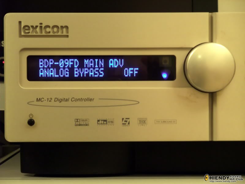

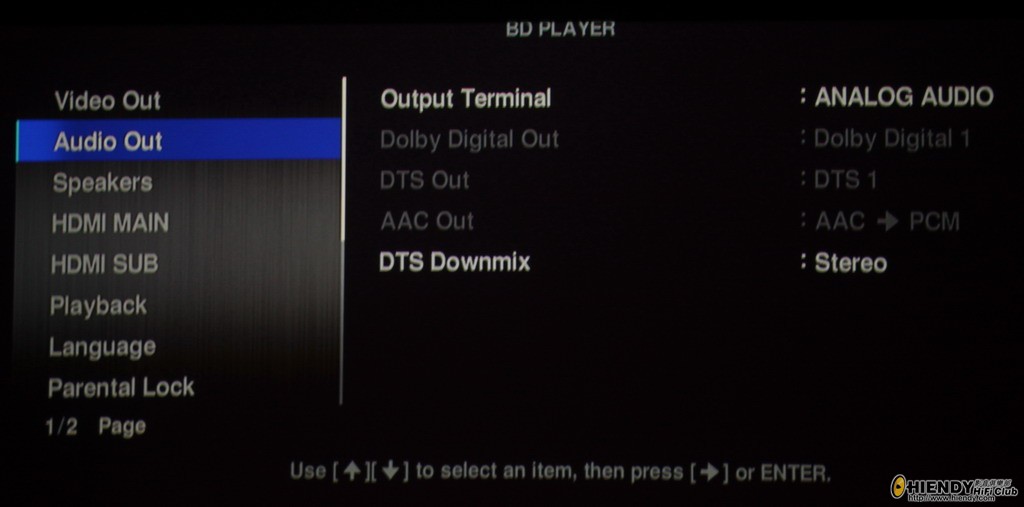

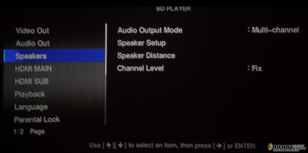

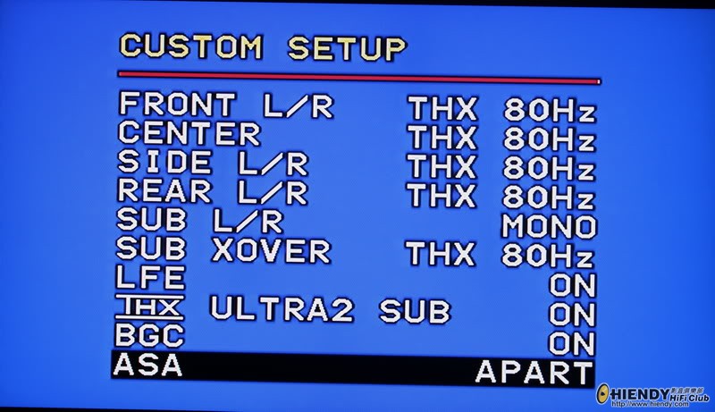

我用 Pioneer BDP-09FD 5.1 Analog Output 至 Lexicon MC-12B V5.25 EQ
Crossover 在 Lexicon 內 Set THX 80Hz

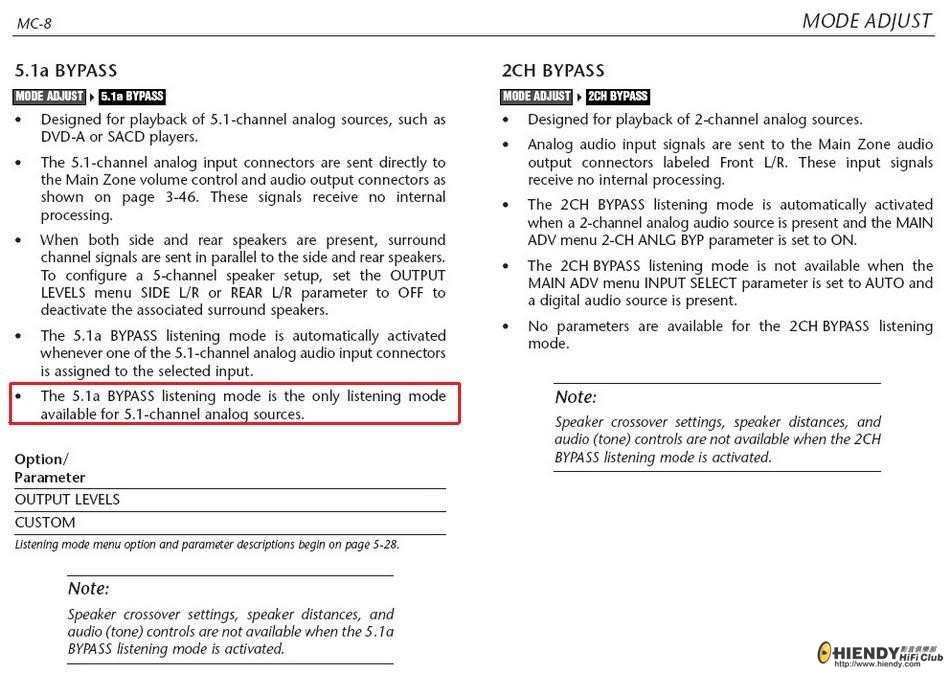

Lexicon MC-12B Crossover Settings

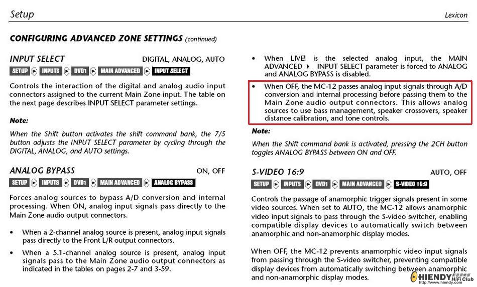

I do not familiar with your Krell
My Lexicon MC-12B can able to allow you to handle the bass management.
You need to check whether your Krell is by-pass (not allow to handle the bass management) when analog input is selected.
Please note the lower grade model of Lexicon such as MC-8, the machine do not able to handle bass management when analog input.  I will only handle by-pass.

Lexicon Lower Class Model --> MC-8B only have analog By-Pass.
Therefore, it cannot change the by-pass to off.
No bass management in MC-8B when using analog input.
發表於 2011-5-10 16:57:28 | 顯示全部樓層
If your Krell does not show changes when changing the crossover, I believe the by-pass is the default (only) mode when analog input.
You may only try to use the crossover setting within Pioneer BDP-09, but it is not very good.
