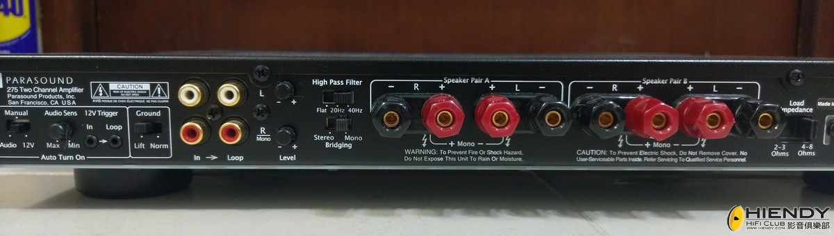

有請師兄教下路,我係用尼作 FH 使用
但係睇到部機輸入有兩PAIR紅白色,又唔知點分佢左右
輸出又有 4 PAIR......(我只係推兩隻 MK5)
麻煩指教一下,謝謝

以我有限知識輸入只需用in位,喇叭只需用A或B組

Please noted that you are setting your amp as bridging mode which means that it can only accept one single channel input (left or right) and connect one single speaker (left or right)ONLY. That connection can use if you have two identical amp and both switch to bridging mode. They are acting like a mono block. Use the two binding post in RED to connect to speaker. look at the MONO indicator under the red binding post and check the polar.
If you only have one amp then you should switch it back to stereo, speak A & speak B are allow you to connect to 2 set of speakers but only one set can use play music one at a time. From front panel you can select either A or B for selected output.
When in stereo mode, follow the normal polar indicated at top, one black and one red for left and right channel.
Ching better check your amp manual to fully understand how you can do the connection to prevent damage to your power amp.

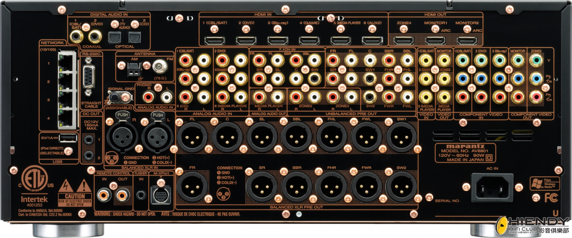

我係用 8801 ,諗住用哩個 parasound 推 FH,  但係前級既輸出信號 RCA 得單一條線的,沒分 紅白

我係用 8801 ,諗住用哩個 parasound 推 FH,  但係前級既輸出信號 RCA 得單一條線的,沒分 紅白 ...
FH pre out 得一邊?應該唔會掛

應該係我表達錯左,我 pre out FH 出尼,有 FHL 同 FHR 兩條,但係我個 275 後級有兩pair 紅白,唔只應該用邊個

插「In 紅、白」,然後喇叭線插「Speaker Pair A」,再將Bridging撥去「Stereo」試試...

好呀,唔該晒咁多位幫忙
