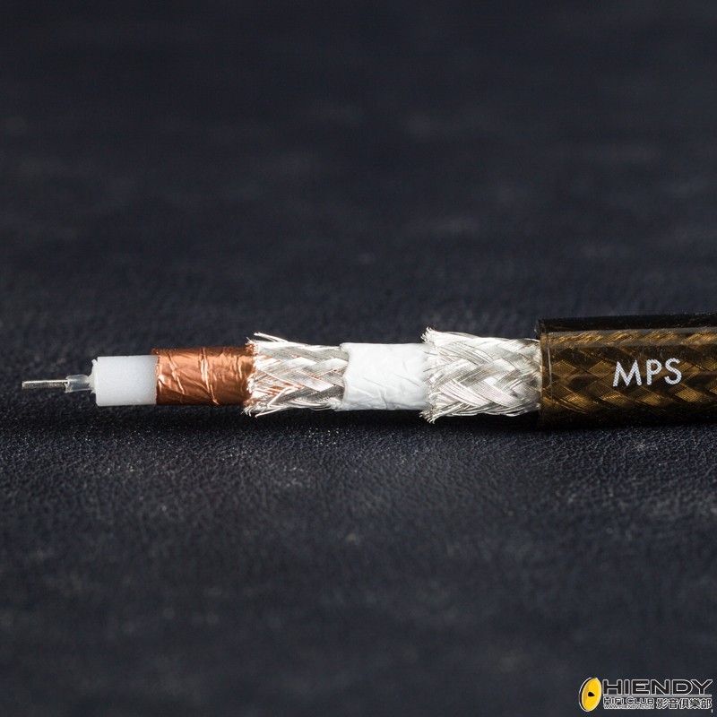

According to the construction of the GX8 cable shown, there is only a single core of silver with two layers of shieldings with copper braids. I wonder where the single silver core would be connected to the pins of the XLR plug as usually pin 1 for common grounding, pin 2 for hot and pin 3 for cold. Is this cable really designed for balanced XLR connection? I'm deeply in doubt!

Ching, this approach use two coaxial cables to make one XLR cable. Is it correct? Any other option? Thx!

Ching, this approach use two coaxial cables to make one XLR cable. Is it correct? Any other option ...
Ching, I'm not sure, sorry!
發表於 2018-11-16 08:15:37 | 顯示全部樓層
本帖最後由 clplarry 於 2018-11-16 08:39 編輯
Panda 發表於 2018-11-16 00:42
I think the other option is to use the two layers of shielding braids for the pins of hot and cold respectively, and the single silver core for the common grounding if only one cable is used for XLR connection. Or, the silver core for the pin of hot connection, the inner shielding braids for the cold connection and the outer shielding braids for the common grounding.
