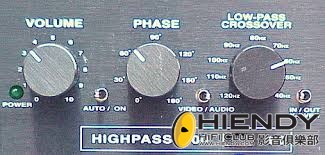

How to setup ( correct ) the phase of your subwoofer : ( In my own opinion)
1, Disable or lower the Crossover frequency of front speaker from the setup manual of AV Amp. And higher the Crossover frequency on back panel of subwoofer.
( Because we can only observe the overlapped frequency sound produced from front speaker and subwoofer on this physical practice . Because enable crossover setting will cut off the signal of overlapped frequency, that will fail the observation )
2, Play a low frequency sound (heavy bass +- 40 to 120 Hz) from your player . ( e.g. phone app < subwoofer test tones >  )
3, Adjust subwoofer volume level similar to front speaker volume.
4, Adjust the Phase switch on your subwoofer (Note 2 *) until the largest volume of bass have heard .
If you find the largest volume production phase angle , means that you got the correct phase now, finally you figure out 1+1=2 right now , a little bit far away from the day of your kindergarten graduation , congratulation!
Note 2* Your can also adjust the phase from the setup manual of some AV Amp by step of every 1 deg. if your subwoofer have not enough detail of adjustment .eg only 0 & 180 deg. My Denon AVR-6400H have that function.
For Denon user : To disable crossover just select LEF + Main on the bass setup at AV Amp, and set Large to the front speaker
