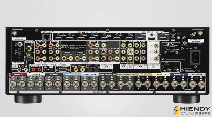

我揾來揾去都吾見有得set 熄左 Denon個 Front channel power.
Config as below : 7.3.4
Denon X6400H Pre-out
FL FR -> External Amp
Center -> Center sub-woofer
Sub 1 -> Sub woofer 1
Sub 2 -> Sub woofer 2
Denon X6400H Speaker output jack connection
Denon X6400 FL FR speaker output                           -> Not connected (吾見有得熄)
Denon X6400 Center speaker output                         -> Center  speaker
Denon X6400 Surround LR speaker output                -> SL SR speaker
Denon X6400 Surround Back LR speaker output         -> SBL SBR speaker
Denon X6400 Height 1 speaker output                       -> FHL FHR speaker
Denon X6400 Height 2 speaker output                       -> RHL RHR speaker

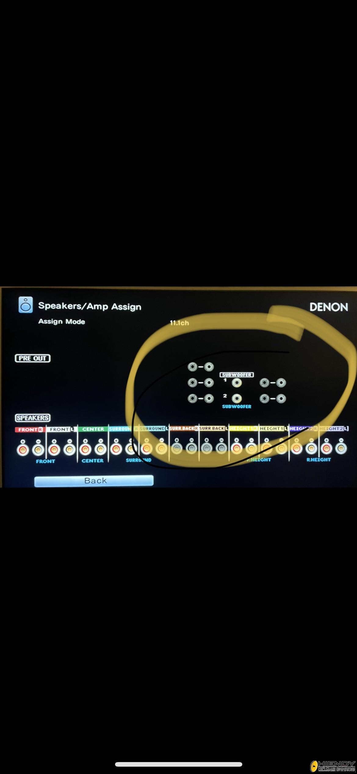

assign mode係要揀 pre amplifier 唔係11.2
發表於 2021-4-9 14:17:52 | 顯示全部樓層
hscar 發表於 2021-4-9 13:58
我部6500好似沒有pre amp選擇
