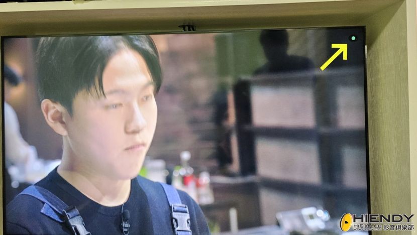

[電視機] 我新買的電視是TCL C755,請問畫面出現這個綠點是什麼意思?

首先請師兄嘗試關閉電視機遙控的 Voice Search 語音搜尋功能,如果綠點仍然繼續出現在 TCL C755 的畫面右上角,請考慮更改下列的電視機設定 -
HOME > Settings > Apps > App Permissions > Microphone > Android 電視機畫面出現綠點的相關 TV App > Microphone access for this app = [Do NOT allow]
希望上述的方法能夠幫到您!
P.S. https://support.google.com/androidtv/thread/300787870/green-dot
Android TV Help: Green dot??
The black oval with a green dot inside it, typically located in the top right corner of an Android TV, is an indicator that the device's microphone is active and listening. This is often referred to as the "mic on" or "listening" indicator. Here are a few possible reasons why you might see this indicator:
* Google Assistant is active: If you have Google Assistant enabled on your Android TV, the green dot may indicate that the assistant is listening for voice commands.
* Voice search is enabled: Some Android TV devices have a voice search feature that allows you to search for content using voice commands. The green dot may indicate that this feature is active.
* An app is using the microphone: It's possible that an app on your Android TV is using the microphone for a specific feature or function, such as voice chat or voice commands.
 樓主| 發表於 2024-10-19 13:05:46 | 顯示全部樓層
ieskn96 發表於 2024-10-19 10:16
首先請師兄嘗試關閉電視機遙控的 Voice Search 語音搜尋功能,如果綠點仍然繼續出現在 TCL C755 的畫面右上 ...
原來開了自動音量,閂咗就再無出現綠點了,謝謝。
