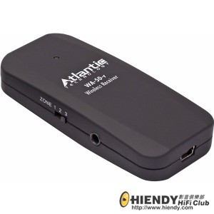

外國地方大, 好多鬼都有玩wireless transmitter, check 下依隻, 吾貴但效果好吾好, 你真係要試过至知.
Detailed Features
System is a full-range audio device, and will accurately transmit the full frequency range of the original signal to CD quality without intereference or delay
Able to set up 3 discrete systems or zones
Connections: 1/8" phono input/output, USB mini and zone switch
Operating range of up to 164' or 328' line-of-sight
Send audio program content wirelessly from a computer (PC or Mac®) to home entertainment system by connecting a transmitter using the supplied USB cable and connecting a receiver to the receiver
Plug-and-play functionality with no software needed
Includes USB AC power adapter, 1/8" stereo cable, 1/8" mono to RCA cable, mini-USB cord and one 1/8" stereo to RCA cabl
比埋條link 你 shopping la
http://www.nextag.com/subwoofer- ... itter/products-html
發表於 2012-3-8 09:50:14 | 顯示全部樓層
要買一set 連 transmitter, receiver 先work.
