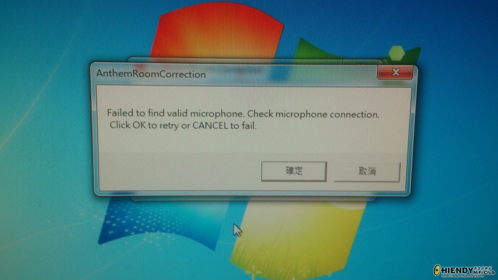

i just bought mrx 300 yesterday, the first time of arq is ok, but there are a problem like this today~
i already update the latest firmware and replug again
please help me ~~~~thank you

thanks ching for reply ~~~is the mic problem or the software problem??
the mic is installed normally~~i can use it as a mic in windows
the usb adp also show port 7 normally and i checked old post have check myself and also not working~~
~~~ but will they open on sunday??

發表於 2012-6-17 03:12:37 | 顯示全部樓層
Rickychan1005 發表於 2012-6-17 00:50
the mic is installed normally ...
USB port  must be assigned to com1 to com6, use your adapter's port manager to change the setting.
 樓主| 發表於 2012-6-18 19:29:04 | 顯示全部樓層
都試過,但係都係唔得,打過電話去問,別超都叫我捧去試,有壞包換。
發表於 2012-6-18 22:10:57 | 顯示全部樓層
電腦玩人,唔洗理由,有排煩.
有師兄講(純粹轉載)如用netbook插咪可能usb唔夠電.
