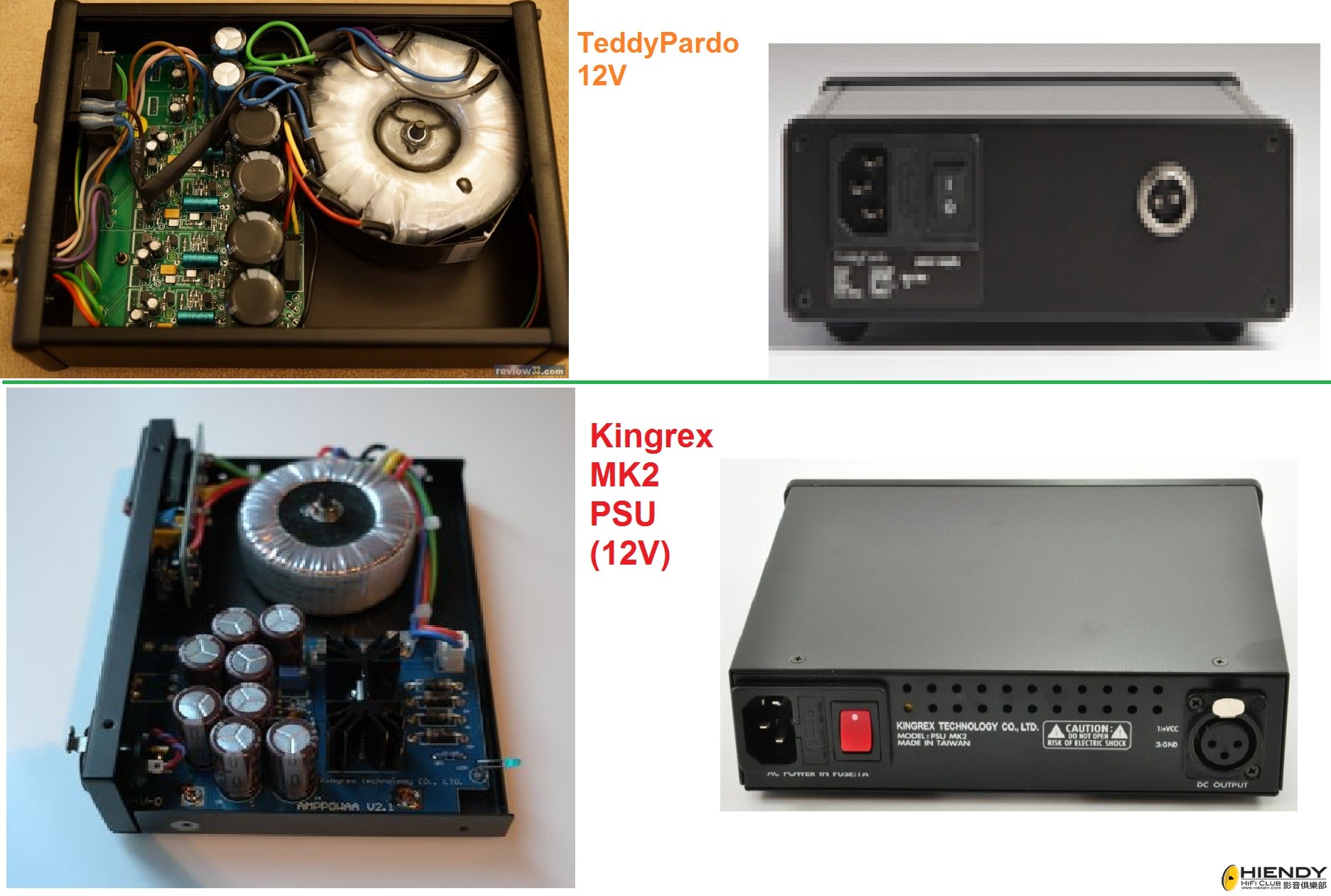

Internal and rear pictures are shown below.  I think Kingrex's internal wiring is more tidy but TeddyPardo's case can provide better EMF shielding.

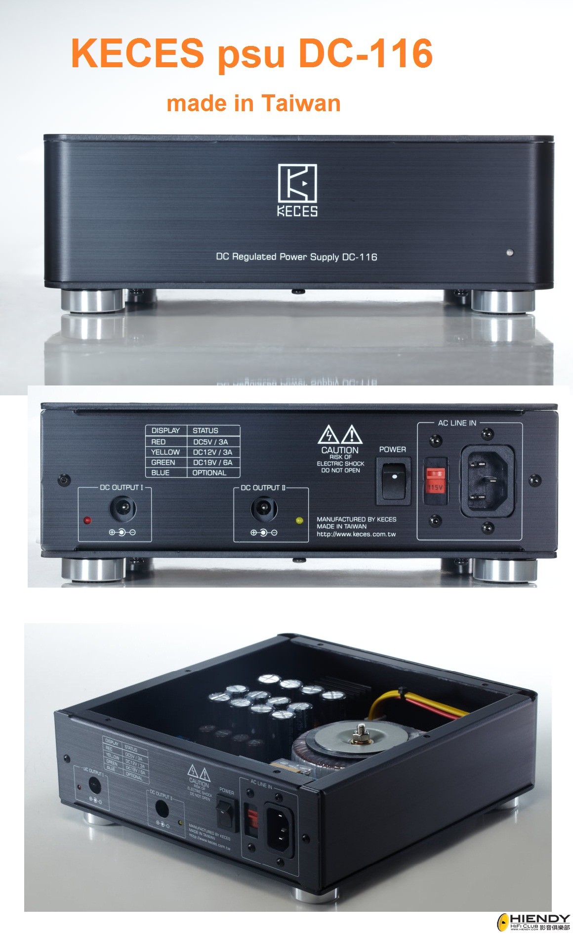

One more choice at medium price:
