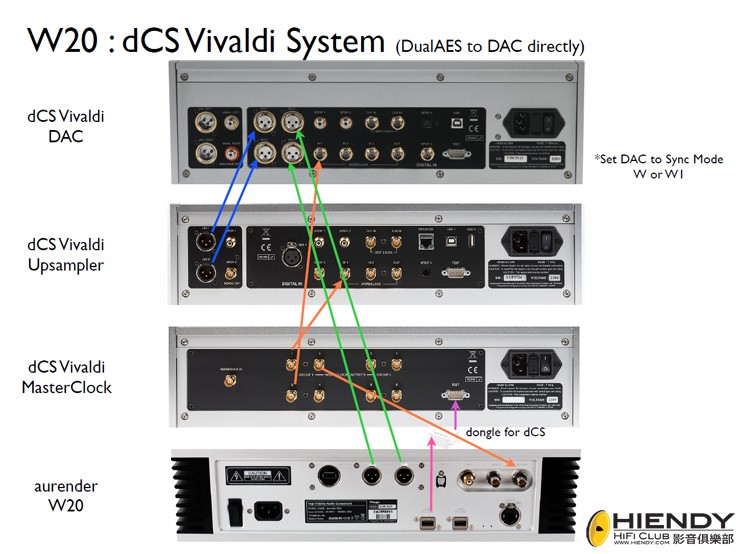

發表於 2019-2-21 20:47:50 | 顯示全部樓層
本帖最後由 vhs 於 2019-2-21 20:59 編輯
sclegend 發表於 2019-2-21 20:43
Thanks for sharing, does that mean if I only have 44.1 kHz source and no other source, I could hav ...
If using Aurender W20, a bit different .......see the attached pic...
發表於 2019-2-21 21:02:07 | 顯示全部樓層
vhs 發表於 2019-2-21 20:47
vhs Ching: Thanks for the detail explanation.
發表於 2019-2-21 21:02:35 | 顯示全部樓層
sclegend 發表於 2019-2-21 21:02
welcome.....

發表於 2019-2-21 22:36:08 | 顯示全部樓層
I did not follow the recommended connections for UPS as per the Aurender website.
The one "to DAC direct" does not upsample signals from W20 at all.  Why the hell do I need the UPS then?
If you check out the Aurender website, one recommended connection is to use USB, though it still asks you to connect the clock.  As USB runs in async mode in UPS, the clock becomes useless!
I connect W20 to UPS with single AES and clock.  It sacrifices the dual-AES capability of the W20, though for red-book 44.1 signals only single AES is used.
發表於 2019-2-21 22:37:06 | 顯示全部樓層
vhs 發表於 2019-2-21 20:24
https://www.dcsltd.co.uk/products/vivaldi-clock/
dCS Vivaldi Master Clock simultaneously sends wo ...
Yes, and Grimm CC1 is a master clock behaving like Vivaldi Master Clock, though Grimm can only output 44.1 OR 48 at any one time.
發表於 2019-2-21 22:37:48 | 顯示全部樓層
本帖最後由 vhs 於 2019-2-21 22:40 編輯
Siegfried 發表於 2019-2-21 22:36
The one "to DA ...
"I connect W20 to UPS with single AES and clock".....good move.....
"The one "to DAC direct" does not upsample signals from W20 at all.  ".......Yes...
