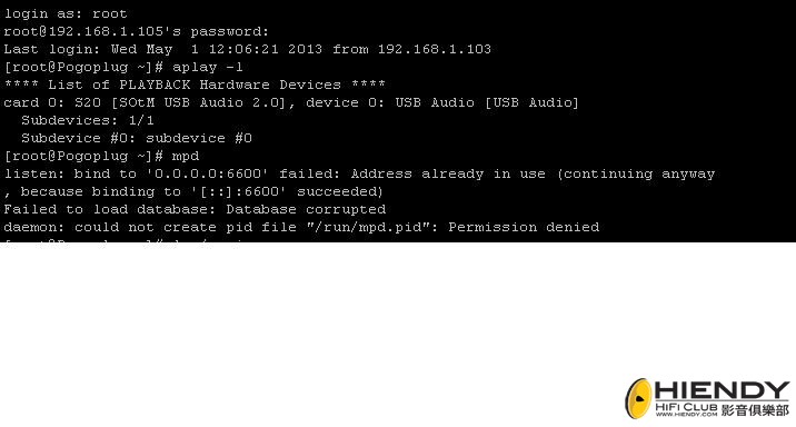

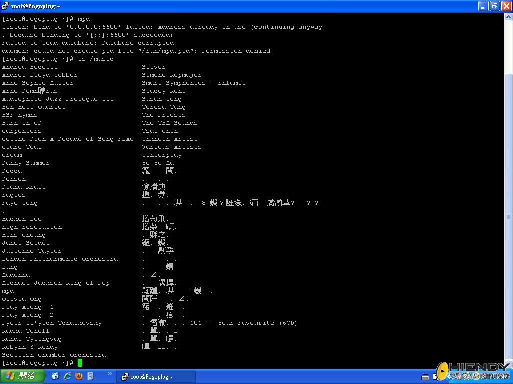

發表於 2013-4-5 08:25:03 | 顯示全部樓層
obee 發表於 2013-4-5 07:47
You can add a "rule" to tell Linux auto mount for you on detecting new USB devices:(or using other ...
Thanks Obee hing
Just tried the instruction, mpd found the USB drive and showed all the files from it.  However when played the file, there is no sound output from the speaker, and the console showed journal commit I/O error.  Then seems the system crashed as whatever command I typed in, its said "no such command".  I pulled the power cord and tried to reboot but with the USB stick drive (where Archlinux was installed) inserted, Pogoplug could not boot up.  Only after I removed the USB stick drive, it can boot up.  Exactly the same as last time I made it work for a while.  Seems I need to re-installed Archlinux again and better stick to NAS rather USB drive.
Will further search on the net to see how to make it work.
Anyway thanks for your big help.
發表於 2013-4-5 22:02:50 | 顯示全部樓層
elo 發表於 2013-4-5 08:25
Thanks Obee hing
Just tried the instruction, mpd found the USB drive and showed all the files fro ...
I suppose you are using stock Arch Linux. The file system in USB drive may corrupt if the Pogoplug was not power down properly, and thus it may not be able to boot again.
Until we can have a read-only root filesystem, don't turn off Pogoplug without proper shutdown.

發表於 2013-5-2 10:50:26 | 顯示全部樓層
hi Obee ching
Thank you so much for your generous teaching. I'm a idiot of Linux. I just follow your post and successfully install the Archlinux. However, mpad cannot detect any mpd server. I tried to type "mpd" on the command line and got the following message
It seems that there is problem running mpd. I have checked music folder, it seems that it connected to my NAS successfully. I have checked "aplay" and seem that the output audio device is ok.
So, can you advise me what's wrong and how can I fix it? Thx
 樓主| 發表於 2013-5-2 11:07:47 | 顯示全部樓層
jonahung 發表於 2013-5-2 10:50
hi Obee ching
Thank you so much for your generous teaching. I'm a idiot of Linux. I just follow you ...
In archlinux, if you want to check the status of mpd, you should run
  1. systemctl status mpd.service
複製代碼
Try to run it and show us the status first.
