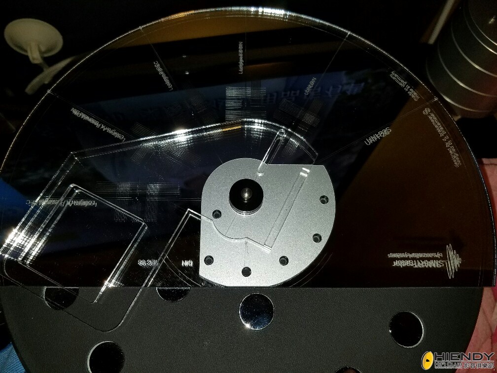

今天去買了,好快俾錢走人,但是回家一開箱,有点失望
發表於 2017-3-20 21:09:02 | 顯示全部樓層
發表於 2017-3-20 21:15:15 | 顯示全部樓層
全新有花,德國佬QC 咁鬼渣
全新有花,德國佬QC 咁鬼渣
發表於 2017-3-20 21:18:14 | 顯示全部樓層
好傷心
 樓主| 發表於 2017-3-20 22:17:32 | 顯示全部樓層
唔使傷心,盡快聯絡我地安排你換一套。
間中被海關檢查過也有機會發現有些這樣情況。

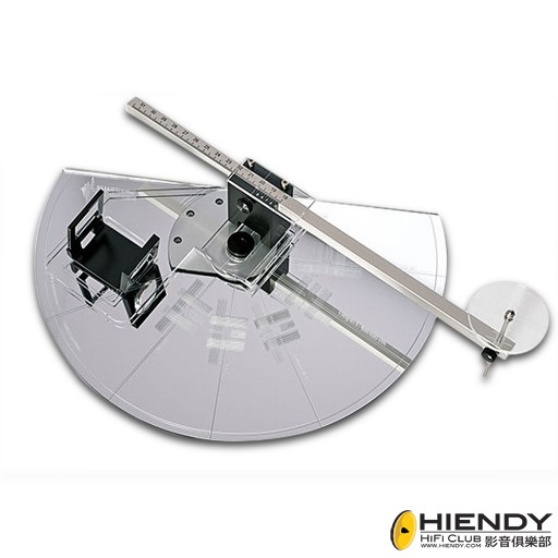

ACOUSTICAL SYSTEMS SMARTRACTOR TURNTABLE ALIGNMENT TOOL
While the UNI-Protractor represents the most universal and versatile phono alignment tool ever introduced in high-end audio, it is an instrument which - due to its complexity and versatility - appeals more to professional users.
The serious audiophile who is interested in aligning - if only periodically - his analog front-end to the utmost precision does look for precision which comes handy and which is easy to operate.
To answer this request we have designed the SMARTractor - a direct off-spring of our UNI-Protractor.
The SMARTractor brings the same unparalleled precise tangential alignment for which the UNI-Protractor earned its laurels - PLUS the 0.05mm precise mounting distance measurement of the UNI-P2S.
Features
- The SMARTractor comes with five tangential curves combined in one template
- The SMARTractor's template is made from 3 mm (= same thickness as 180 g LP) strong premium grade German
  XT mirrored acrylic supplied by Evonik
- No-error-possible single-point alignment with 3 mm deep parallax (for ALL helping lines) - an extreme precise,
  easy and fast alignment
- Super easy to use with one-point fixed setting for every tangential curve
- All alignment lines are CNC-laser cut hairlines
- Incorporates real glass aluminum-frame magnifier with automatic focus jig for unrivaled precise magnified view
  during alignment
- All five tangential alignments are based on true triangular positioning and thus are independent of effective
  length
and thus suitable for ALL pivot tonearms, no matter what their effective length or mounting position
- The SMARTractor further comes with in-built direct mounting distance - P2S -measurement with 0.05 mm
  accuracy

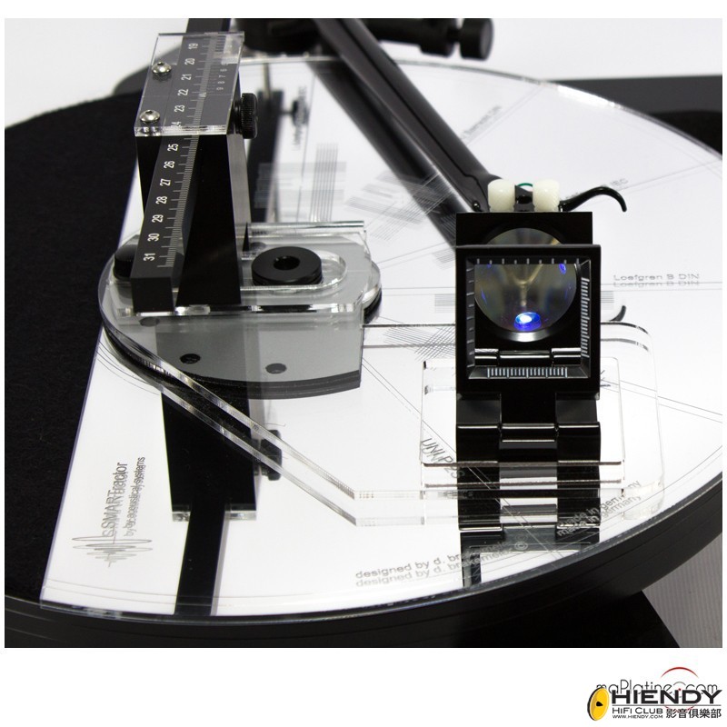

This is best protractor I've used. The design of the gauge makes it both flexible (allowing one to choose different geometries) and easy to use. Everything is well thought out, even down to the loupe that provides a great view of the stylus and cantilever, making precise measurements much easier. - Galen Carol
The SMARTractor features the critically acclaimed UNI-DIN tangential curve. An all new tangential curve using the latest calculations. In the last 2/3 of the record's groove, the UNI-DIN curve offers significant (18-45%) less average - as well as less total! - distortion than Baerwald or Loefgren. Sonically this gives you less stress on human (female) voices, more subtle details, less "grain", increased "air" and considerable more "headroom" in critical passages and especially so in climaxes.

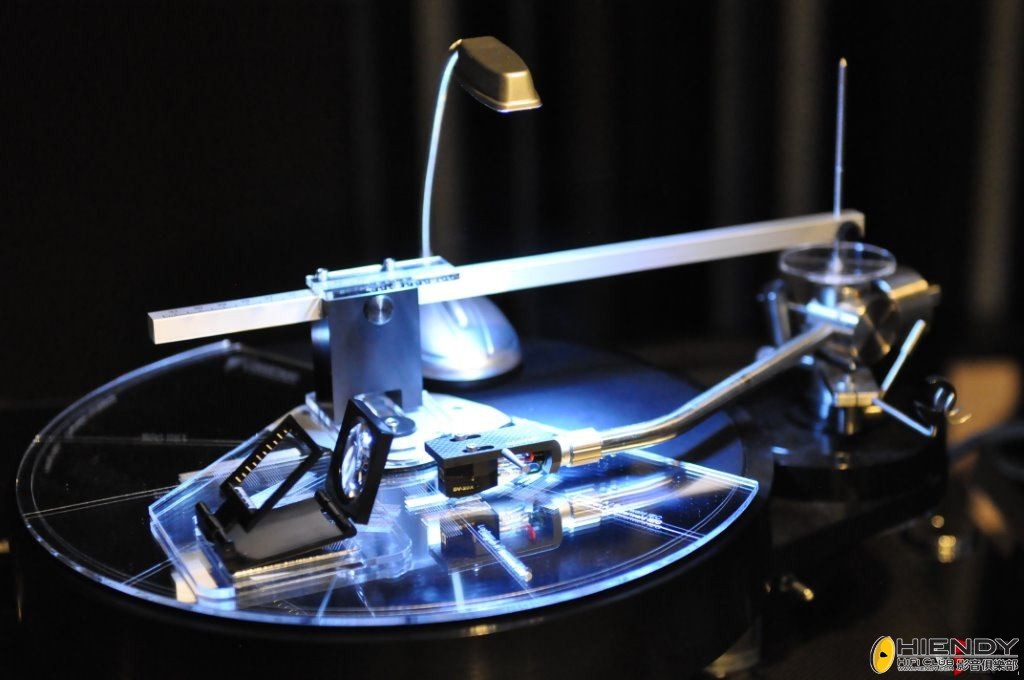

The SMARTractor is probably the finest, most intelligently designed tonearm alignment tool available on the market.
So, what’s special about the SMARTractor?
The SMARTractor now comes with one nylon centre bush, with a universal ‘gripping’ insert that is much easier to use than the previous arrangement of 3 separate bushes to accommodate different spindle sizes.
A unique bundle of features:
The SMARTractor comes with 5 tangential curves combined in 1 template.
the SMARTractor’s template is made from 3mm (= same thickness as 180 gr LP) strong premium grade german XT mirrored acrylic supplied by Evonik.
no-error-possible single-point alignment with 3mm deep parallax which means you can line up the cartridge cantilever very accurately against the calibrated marking and their reflections – you can be 100% sure that you’re looking from the correct angle.
enables you to precisely align a cartridge according to its cantilever, rather than the body sides.  Ever tried to align a cartridge body that does not have straight sides?  No problem at all with the SMARTtractor, even when the body obscures the cantilever.
super easy to use with 1-point fixed setting for every tangential curve.
all alignment lines are cnc-laser cut hairlines.
incorporates real glass aluminum-frame magnifier with automatic focus jig for unrivalled precise magnified view during alignment.
all 5 tangential alignments are based on true triangular positioning and thus are independent of effective length and thus suitable for ALL pivot tonearms, no matter what their effective length or mounting position.
The SMARTractor further comes with in-built direct mounting distance – P2S -measurement with 0.05mm accuracy.
