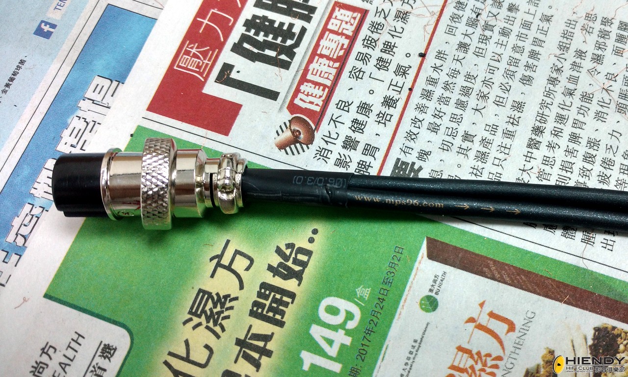

發表於 2017-3-22 17:13:58 | 顯示全部樓層
昨天用 X9 做了 DC cable 俾 Media converter (Optical <> LAN) 同 router,很好很好效果。今日繼續做多條俾 fanless (12V 6A),兩條 X9 打孖上,希望唔好著火 (附圖)。

發表於 2017-3-22 21:52:19 | 顯示全部樓層
PhantomGTR 發表於 2017-3-22 17:13
昨天用 X9 做了 DC cable 俾 Media converter (Optical  LAN) 同 router,很好很好效果。今日繼續做多條俾  ...
X-22粗d,唔使打孖上

發表於 2017-3-23 16:07:44 | 顯示全部樓層
What equipments you connected with both ends of aviation plug?
發表於 2017-3-23 16:25:07 | 顯示全部樓層
clplarry 發表於 2017-3-23 16:07

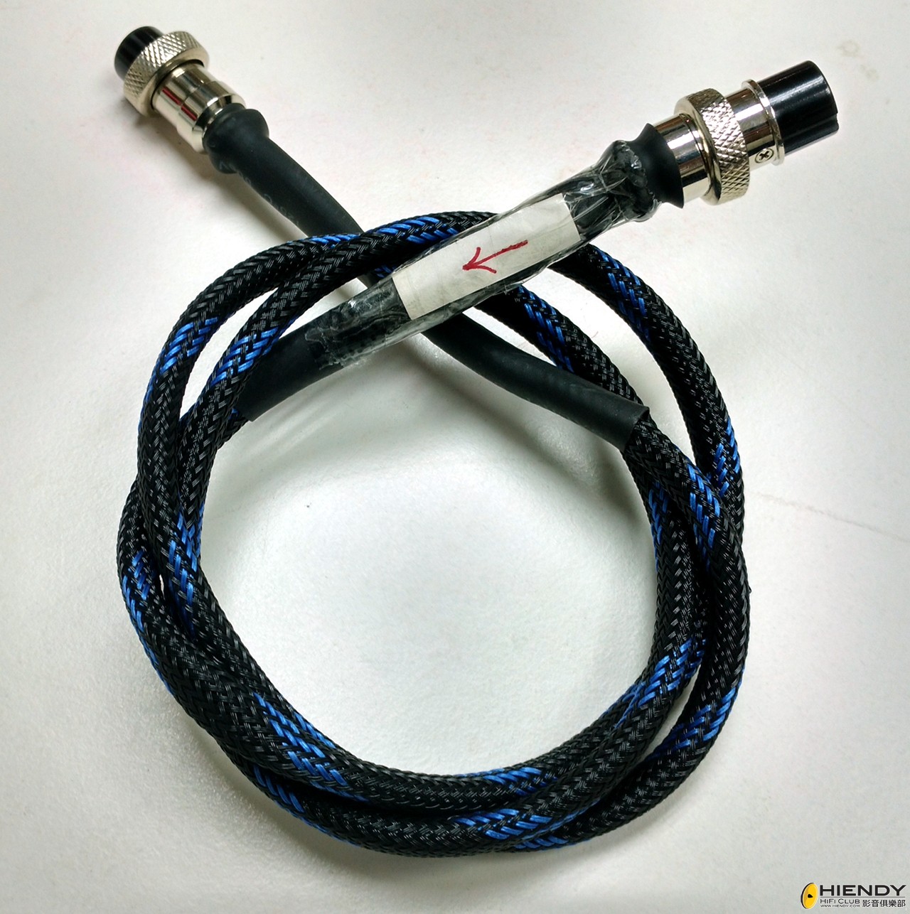

This?  LPS to Fanless PC (from Edison133), according to Edsion133, most of the time, the fanless draws 3-4A only. Occasionally full loading with graphic card will shoot to 6A.
發表於 2017-3-23 16:41:16 | 顯示全部樓層
PhantomGTR 發表於 2017-3-23 16:25
This?  LPS to Fanless PC (from Edison133), according to Edsion133, most of the time, the fanless d ...
Very good workmanship beatifully made. Did you use double x9 OCC with silver plated cable to have it done?
發表於 2017-3-23 17:06:16 | 顯示全部樓層
本帖最後由 PhantomGTR 於 2017-3-23 17:08 編輯
clplarry 發表於 2017-3-23 16:41
Very good workmanship beatifully made. Did you use double x9 OCC with silver plated cable to have  ...
Thank you very much arh, c hing.  That's too much to me la.  I used 1  X9 for each "+" & "-", and connected the shield of both X9 to the GX16 "-" to ground the shield.
Here, I don't know that, will it be better (or correct) if I use 1 wire from each X9 to connect to a pole, rather than now I use whole X9 to connect to a pole?  Yet the sonic performance is really not bad.  I'll leave it for few weeks, could be even longer.
發表於 2017-3-23 17:24:09 | 顯示全部樓層
PhantomGTR 發表於 2017-3-23 17:06
Thank you very much arh, c hing.  That's too much to me la.  I used 1  X9 for each "+" & "-", and  ...
I think Each cable for each pole is better for individual shielding of positive and negative DC in a single cable. Generally, the end to the LPS should be grounded to the aviation plug while the end to the equipment is no any grounding (cut all the grounding net and isolate with shrink tube to prevent touching from the aviation plug)

發表於 2017-3-24 00:00:01 | 顯示全部樓層
本帖最後由 PhantomGTR 於 2017-3-24 03:02 編輯
Mission failed.  度過條線係電腦個邊係有 12V出的,但一見到 Win logo 部 pc 就自己關咗機。行返 Voyage MPD Linux 就無事,仲要勁好聲。
明天訂條 M9 回來,再做過!
