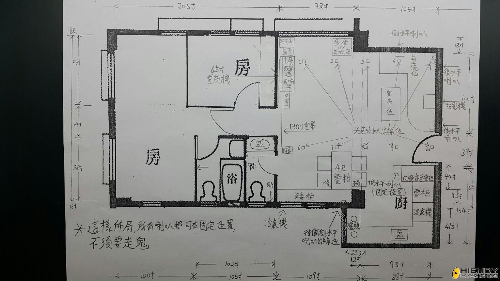

多謝2位版主及各位師兄的指教,因小弟感冒仲未好番,待精神番d再畫過張floor plan出來給各位師兄睇睇,看看這個折衷方法可不可行。

發表於 2018-4-14 12:15:10 | 顯示全部樓層
Dear Ivanso hing,
Hope you have recovered from your cold/flu.
Congratulation to your upcoming happy and exciting big AV improvement project.
It is exciting to be able to have a near 30SM area as your own private home theater. So happy.
I am a designer/contractor and an A/V enthusiastic. There are few issues would like to share with you.
A.        Do check the turning radius of the staircase of your building. A 130” electric screen is rather long. If the staircase/corridor are too narrow. May not be able to fit.
B.        How many people living in the apartment ? The screen blocking the corridor may affect the flow of the apartment.
C.        About the Mains power supply. It is advisable to replace the mains cable from the electric meter located on the public staircase/corridor to the MCB in your apartment. Using “Hager” MCB box will be more convenience for you to choose Audiophile grade MCB/RCCD switches.
D.        Since you are using ‘open kitchen’. And the stove is facing the windows. It is better to use electrical induction stove to comply with the Fire/Building ordinance. (However, it did will consume more electrical power from your apartment.)
E.        Are you planned to have ‘False ceiling’ ? It may be good to have false ceiling so that all the Atmos speakers can be ‘in-ceiling’. Also can hide/cover the Beam which run along the middle of the living room. Can also cover the light which will be emitted from the top of the curtain along the windows.
F.        Optical fiber HDMI cable is best choice. There are few brands which have small connector which will fit the 32mm conduit.
G.        If the budget allows. Using galvanized metal conduit will further reduce the RF/EMI interference to the speakers/electrical/lan cable.
H.        Sometimes need to find compromise solution between the A/V requirement with the actual environments and the needs of your family members. ^_^
Just my-2 cents.
Thanks.

 樓主| 發表於 2018-4-15 23:58:51 | 顯示全部樓層
本帖最後由 ivanso 於 2018-4-16 00:14 編輯
多謝各位版主及師兄關心,小弟今日精神好番好多了。
綜合咗版主及各位師兄的意見,現從新再作出編排, 在多方面加以改善及有少少妥協, 懇請版主及各位師兄睇睇有無得再改善好啲?
有勞各位!

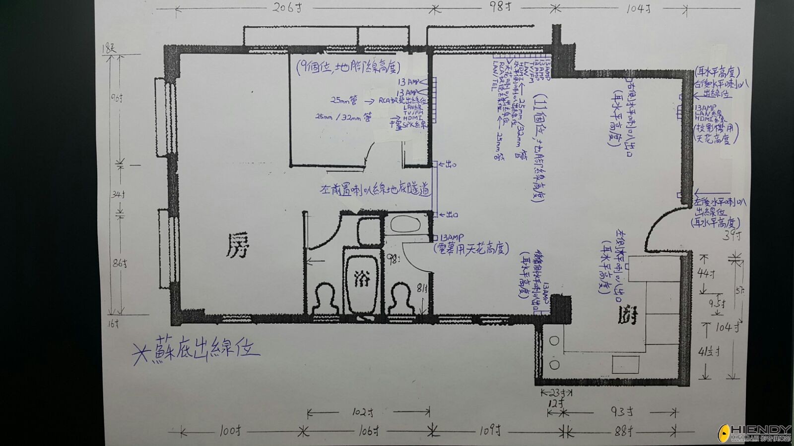

以下是新繪畫的Floor Plan。(如以下圖位置用7.1.4方式,所有聲道的喇叭將可有固定位置安放,不須要走鬼.)
在上圖(floor plan)如要行7.1.4的方式,4個天花喇叭位置應用那4個出口(1號-10號)為最佳選擇?
以下是蘇底出線位,而天花喇叭的10個出線位與新繪畫的Floor Plan相同。
發表於 2018-4-16 06:52:07 | 顯示全部樓層
本帖最後由 Csum123 於 2018-4-16 07:06 編輯
Ivan 兄
少少意見⋯⋯
個router/switch 同NAS 會放係边?寬頻又由邊度入?我估計是在AVM位。出入cat6也要考慮的。會影響RJ45接頭數目和cat6佈局。估計最少要1入3出。去電視、去network player、去projector.
AVM -> 拾仔rca 預走明線?
電視背後缐 <-> 牆腳位 走入牆線糟會好看点。
電幕是否用遙控?咪要預控制線岀入口。
咁多天花喇叭線要返AVM位,要用線糟了。
發表於 2018-4-16 11:23:05 | 顯示全部樓層
ivanso 發表於 2018-4-15 23:58
綜合咗版主及各位師兄的意見,現從新再作出 ...
想玩得開心,趁機會裝隔音, 特別係隔音門。
