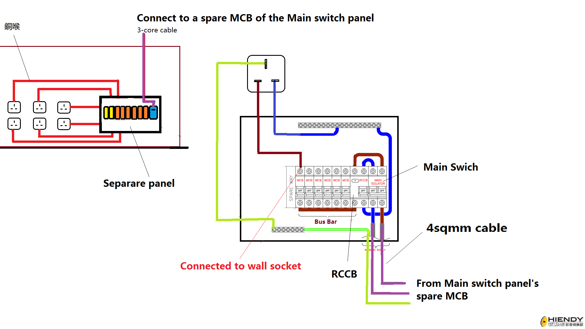

In the main switch panel, just pick one spare MCB and then connect it to a SEPARATE switch panel with a main switch, a RCCD and also N number of MCBs connecting to N number of wall socket via Prysmian or Pirelli 4 sqmm cables .  Very simple!  You will get much more quiet sonic background.
Ir should be better to use copper pipes to house the Prysmian/Pirelli 4 sqmm cables but PVC conduits should also be good enough!
發表於 2016-12-20 20:51:41 | 顯示全部樓層
本帖最後由 nagramen 於 2016-12-20 21:05 編輯
Schematic wiring diagram above
發表於 2016-12-20 20:54:20 | 顯示全部樓層
本帖最後由 nagramen 於 2016-12-20 21:07 編輯
Once more!
I only use Hager MCBs which cost under HK$20 each but are good enough for the time being!
To save money, the separate panel may be place near (say 1 foot from) the wall sockets!!!

後來實際的做法,是請水電師傅按照安裝電熱水爐的方法,獨立電箱直駁主電,拖四條獨立 fuse ,拉線出四對插頭。普通電線 4mm,不用什麼特別材料的線和插蘇板。看他們安裝電熱水爐就是音響電的規格,不如照做。
煲一個月,得左。最初一開聲已經比舊居的什麼銅什麼白金優勝,低音不會削左去,細節不會少,音色自然。聽到現在,沒有特別要煲電的需要,開心聽歌。
用電線和插頭,還是銅最好。
