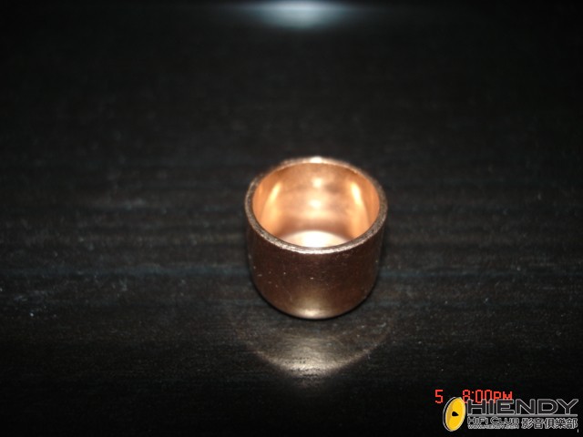

我朋友介紹我用的平價聖杯。
這是銅喉的蓋(水管)。 幾元一個。佢話相當有用,我暫時未試過。

The size of 聖盃 resonance at a particular frequency.  Given the size of the 聖盃, this frequency unlikely to be the bass frequency we need to handle.
Appreciate if somebody could explain the physics which allow one passive device resonance in frequency A but have the ability to reduce standing wave of frequency B?
The swimming pool analogy in post #1 is not applicable to explain why 聖盃 works.
1/ 聖盃 is a passive device.  Dropping a can of coke creating some wave which is not what a passive device doing.
2/ "A big fat guy" jump into the pool or "a baby boy" or "a can of coke" drop into the pool create an impulse.  These impulse travel at the same speed on the surface of the pool and they interact with each other.  It does not explain how a passive device resonance in one frequency could reduce standing wave of another frequency.
It needs a different set of theory to explain how it works.
 樓主| 發表於 2015-6-6 12:45:04 | 顯示全部樓層
eds60 發表於 2015-6-6 12:18
我朋友介紹我用的平價聖杯。
小弟搵到個 叮叮,都好平

非常同意最後嗰句, “最多話用左聖杯某段高音多左, 相對高音多左低音聽感上好似小左”
有點像用咗銀線高音清咗, 低音似少咗。 用 sound level metre 度, 其實沒有變。

其實,好多平的方法都有效果.
聖盃值唔值就見人見志.
(香港早年聖盃熱潮後期,變了用得多,等於有錢的象徵, 好似鬥多鬥貴咁)

小弟都用緊幾隻聖杯,覺得房間細的話<55尺左右,再加上近場,效果真係明顯得好緊要
尤其係擺二音箱中間果隻銀杯,係可以大幅加強音樂層次感同分離度
不過亦有drawback,聲音會無咁自然,也就是會加上點染色
至於對standing wave,個人覺得幫助不大,應boom的地方依然會boom

darkfrank兄, 如有興趣可去睇下小弟個關於房的post 。 我都有三年時間在70尺,6尺9寸高的房近距離聽。
銀杯較強調高音, Gold Special 較強調中音但很貴。 試下玩那17粒一套的 Sugar cube, 效果不錯, 價錢又不貴。大名鼎鼎的 kyu888兄都有玩 Sugar cube.
