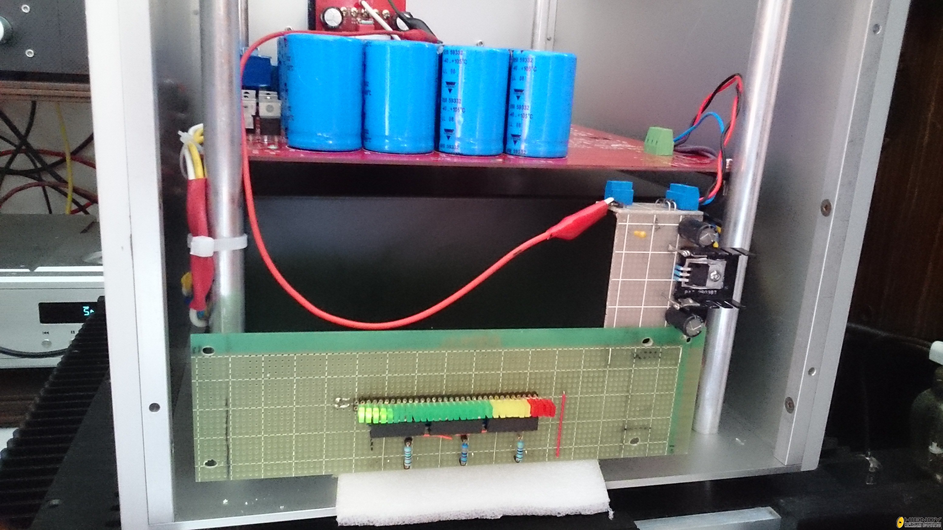

套狗文後級面板好齋,去買洞洞板做LED VU錶

買洞洞板搭咗套30粒LED VU meter,彈吓彈吓
