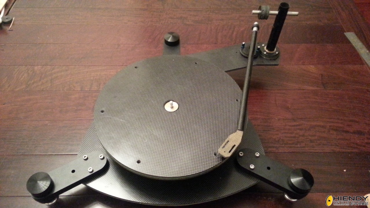

The platter, also cut from sandwich carbon plate

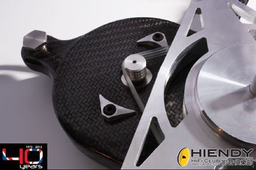

It's all built from scratch. Here is the TT's CNC bearing and pulley made of copper
The base is m ...
From the choice of materials, you must have already had a great understanding of the role of positive resonance in tt! Wow, a real master work!

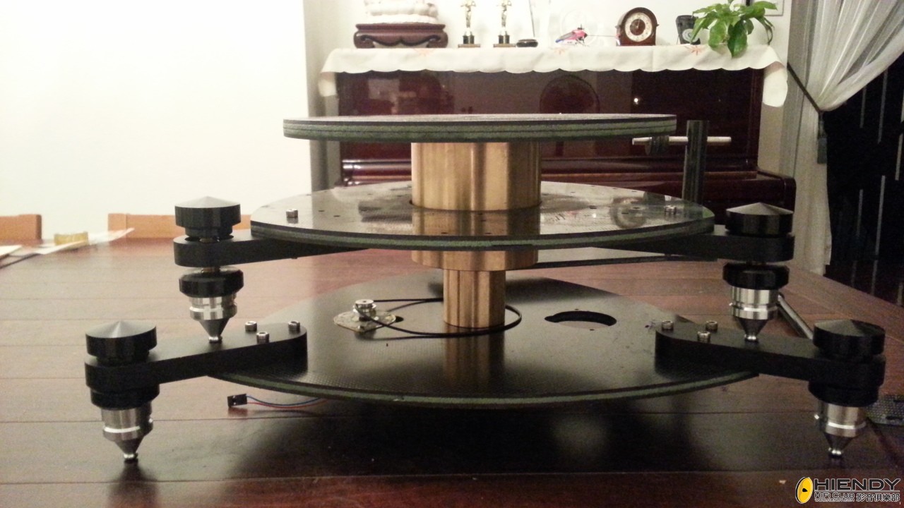

Thanks Poire Hing. Regarding resonance, sandwich carbon fibre is the right way to go.
The point of arrival is a double deck FMD TT. I'm sourcing magnet with directional flux.

The double deck design has been quite popular among a number of high end British TTs such SME, Audio Note and EAR. Is it an attempt to capitalise on the advantage of having layers?
Do you have the intention to use a magnet with directional flux as bearing (just like JC Verdier)?

The upper deck platter is driven by the lower deck motor mechanic via magnetic flux (Free Magnetic Drive), thus the platter is totally isolated from any vibration and noise caused by motor, belt etc...

Video showing my first DIY 12" (well tempered alike) carbon fibre tonearm
http://www.youtube.com/watch?v=LsdAMUSYdT8

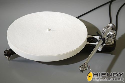

Rega's newest 40th Anniversary Naiad TT (£30,000) is also making of foam filled carbon fibre!
http://www.the-ear.net/news/rega-naiad
