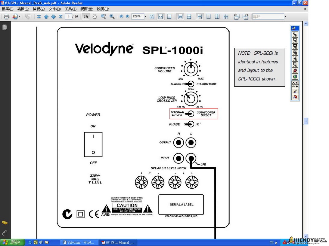

velodyne subwoofer 後面 x-power 制? 咩尼?
等我check check 先

如果你講依亇制,
最好拍去 Subwoofer Direct,
飛開subwoofer internal x over

    ryanenen兄,請問subwoofer direct係咪即係個sub設定幾多crossover,嗰sub就會做嘢而唔係amp嘅設定呢?thx

No, its just the opposite.
No matter what you set low pass x over frequency of the subwoofer. If you switch to subwoofer direct, the LFE signal from the AV amp will bypass the low pass x over frequency circuit of the subwoofer. Usually it is better for the AV amp bass management to handle the LFE signal before sending to subwooofer.
