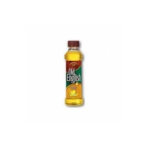

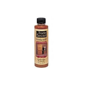

Look like this:
they should got 2 types mainly, one is red oil for dark wood and the other is yellow oil for light wood.  Please don't use those spray can type as it contain wax.  If you find this Old English hard to find in HK market, you may also consider the brand call Trade Secret" which you can easy find them in CitySuper
Hope this help!

hummm... from my understanding, I will classify:
Dark wood: ebony, rosewood, etc...
Light wood: maple, oak, etc...
But please bear in mind, what I talked above just assumed the neutral wood color only.  Like AI hing's offrande supreme, it is light wood.
So if you not sure, go get light one as it is the most safely way.

    sinner hing,
    好詳盡解釋,我就除用 lemon 紅油外,會用你講個隻 TS 透明油。因我對 offrande 係 cherry 色帶紅,用紅油無問題,但用得紅油多怕都會沾色,所以都用 TS 隔住用,
   其實如果淺色木,最好都係用 TS 透明油。 我以前有對 walnut 3/5a 長期用lemon黃油,後來發現令到顏色偏黃好多,後尾用lemon紅油修正返d 色。
   另有一隻以前係日本 tokyu hands 買返泥的 橙油 orange oil 都好好用, 一樣 wax free.

    Terence hing,
    長期用係會有變色的,所以用透明的安心d,如果用有色的,同唔好比太多油停係本表面太耐都唔大問題。
   我以前抹時會用多一點,等木皮索油,但係對黏木皮的箱就唔好簪咁做,我試過
   有對 proac tab  索油後邊脫皮及拼接位裂開。
