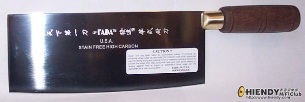

May I also suggest arranging a group purchase for "天下第一刀" from Mr Knife's company.
http://www.ctnyus.com/products.asp?id=431
I think it should be very popular and it should be one of the hottest product for Hiendy's members as most of us are "fans" of Mr Knife.

你講笑吧﹐音響鋪賣刀會笑死人
About number one knifes , we have made in China and Made in USA , stainless steel 440A, call Class A;stainless steel 440B, call Class B ; stainless steel 440C, call  Class C. 440C stainless stell knife is number one in the world , but it's not HIEND ,154cm(Model)stainless steel is hiend now.
