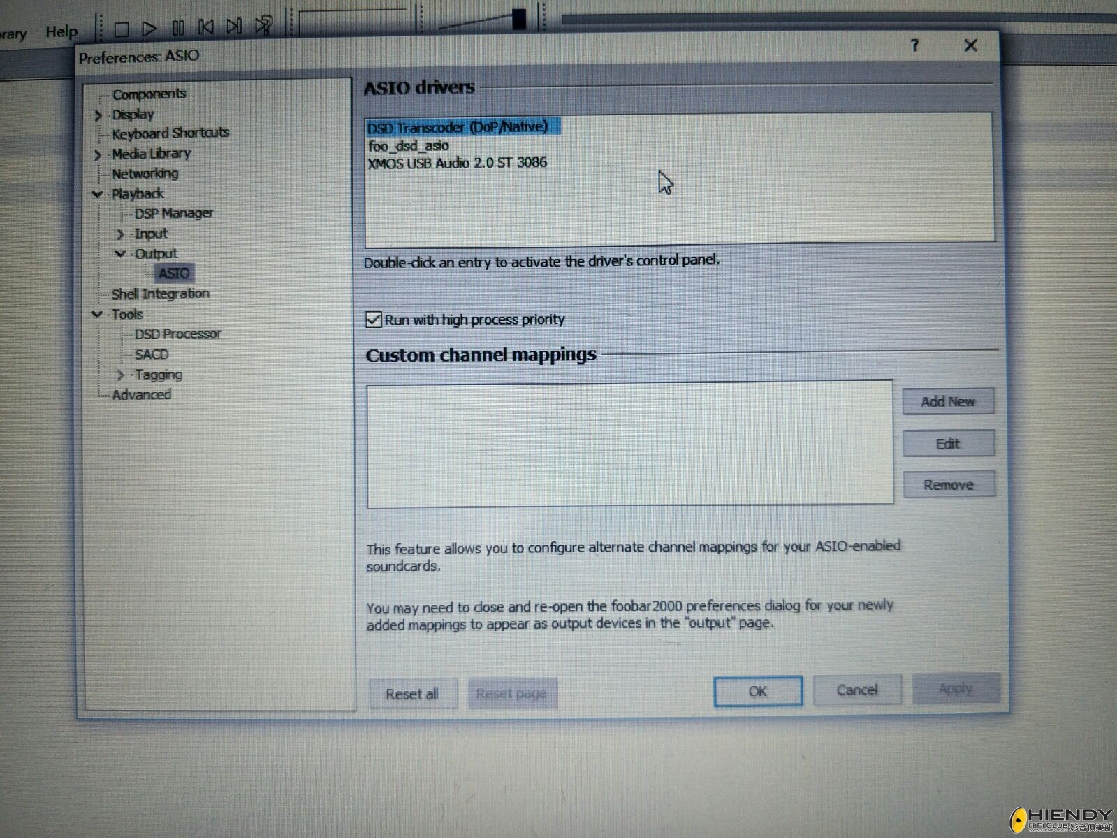

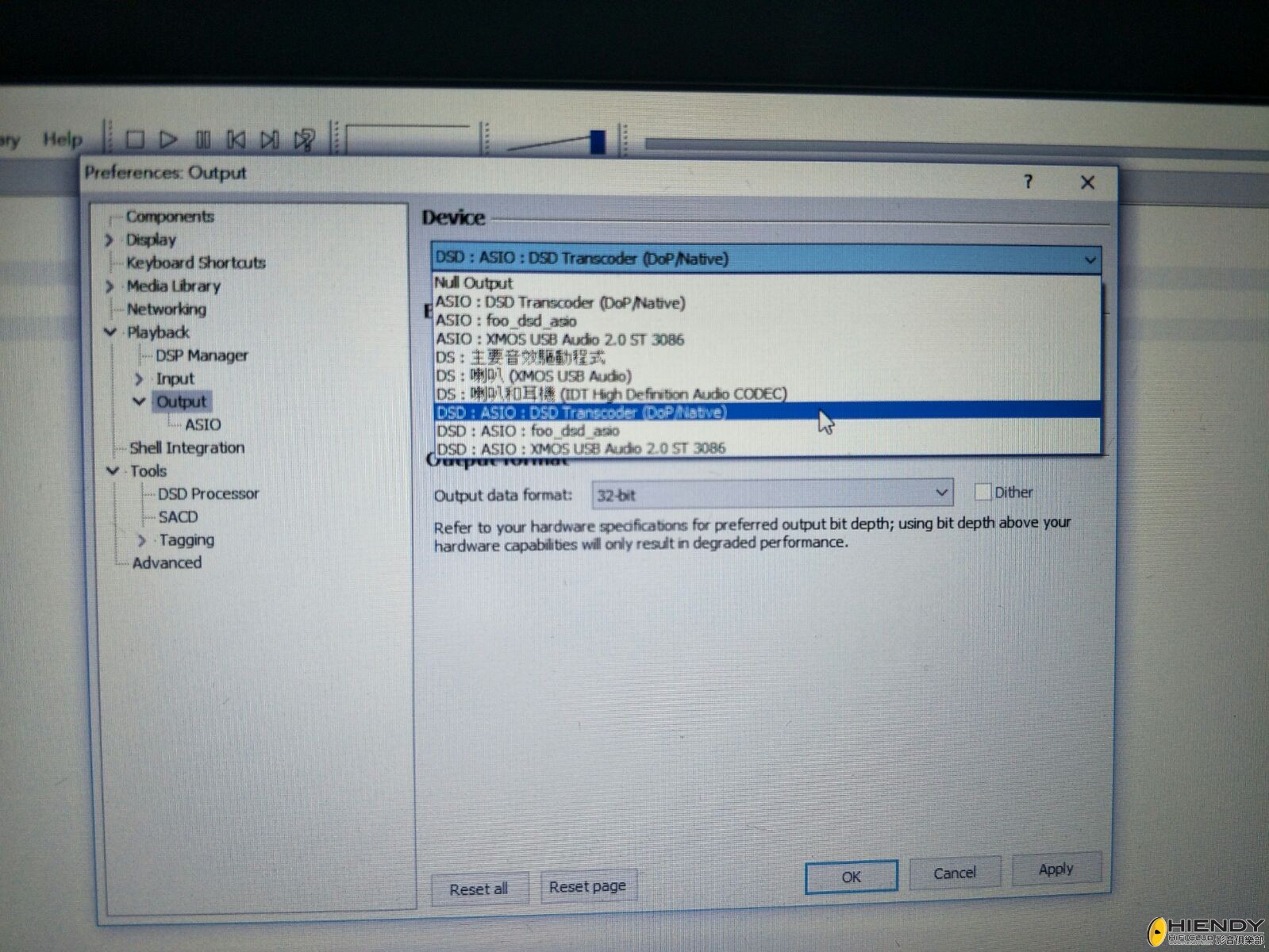

I tried to install the DSD Transcoder (DOP/Native) this morning but couldn't open the control panel by double clicking of it. Though I have selected it as the output device, it couldn't be activated to work when I played any music files with error message (unrecoverable playback error: could not open the driver)
 樓主| 發表於 2017-7-25 10:50:29 | 顯示全部樓層

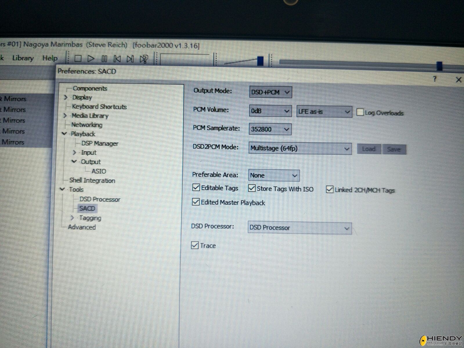

One interesting condition is that when I selected the SACD output mode to DSD only, it could play all DSD files with the correct bit rate shown on the display panel of the Holo Spring but no any sound was produced for DSD files  (actually the music was playing with the operation cursor moving slowly.)
But if I selected the SACD output mode to DSD+PCM, it could only play DSD files to DSD64 with correct bit rate showing on the dispaly. All DSD files for DSD128 and upward couldn't be played with a line of dots on the dispaly only.
So, if the sound output for DSD output mode could be achieved, the problem would be solved accordingly
