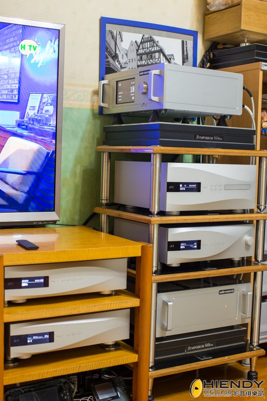

Hi CKKeung,
I have used ARC 40th Anniversary pre amp for some time. The sound suits my taste so it was recently changed to ARC Reference 10. Ref 10 has slightly better resolution and more defined sound stage.
My CAS uses Synology DS213j NAS through Netgear AC1900 router. It goes through dCS Vivaldi upsampler. All signals are upsampled to DSD between sending D/A processor.
From my experience, there are several things that affect the sound from CAS.
1. The power supply has to be clean. Common switching power supply is very noisy. It has to be replaced with linear power supply.
2. The LAN cable has a strong influence of the sound, use the best LAN cables you can buy and you will not be disappointed. I use Audioquest Diamond.
3. dCS uses external clock for the whole digital front end. The performance of the clock determines the sound. Adding a GPS disciplined clock for 10mHz reference boosts the performance of the clock by some margin. The clock should not be overlooked if you want the best result, even the digital cable for the clock can have effect on the sound.
4. Isolation or vibration control will sharpened up the sound and enhances image.
Setting up a good sounding CAS/NAS is like setting up a good analog system. Everything counts. It really takes some times and effort to triad and error, in order to get the best result.

Hi momei,
Yes, I have dowloaded and brought some HD tracks from HDtracks, 2L, B&W and Blue Coast. I find DSD format sounds better in my system when compared with other formats and frequencies.
dCS Vivaldi cannot handle double DSD, so I cannot tell whether DSD128 is better, but in general, DSD format is better. I think the way the music is recorded and mastered is more important than the format and frequencies. Some of the 16/44.1 or 24/44.1 files sound great. The 16/44.1 files I ripped from my CD collection sounds great. In fact, the best sounding files are the DSD files I ripped from SACD using a PS3.
I have compared different files ripped from the same disc using different PS3. They sounds different. I am lucky to find a mint PS3 with firmware lower than 3.55. Everyone knows the laser pickup head will age with usage. If you have a really used PS3 with many hours of playing, the laser head would not be top notch.
Vivaldi has volume control and it sound great playing it direct to power amp. There is slightly more resolution, more punch and dynamics. But it is a bit too harsh for my taste and can sound edgy with some misic. I find myself can fall into the music much easier with the preamp. Playing without preamp, I tend to listen to the sound, the different frequencies, not the music if you know what I mean.
