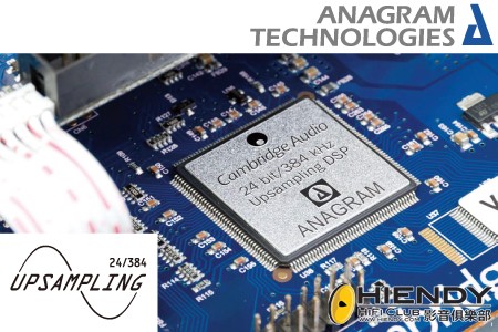

I use  Anagram Technologies "ATF2" Upsampling  => Cambridge Audio
ATF2 TM (2nd generation Adaptive Time Filtering), an upsampling process developed
in conjunction with Anagram Technologies. This intelligently interpolates incoming audio data to 24-
bit/384kHz through the use of a 32-bit Analog Devices DSP (Digital Signal Processor). ATF2 system applies
sophisticated polynomial curve-fitting interpolation and incorporates a time domain model which adaptively
generates the new data in the temporal domain, dramatically reducing digital jitter.
Even High-End CD Player use => Anagram Technologies ATF
