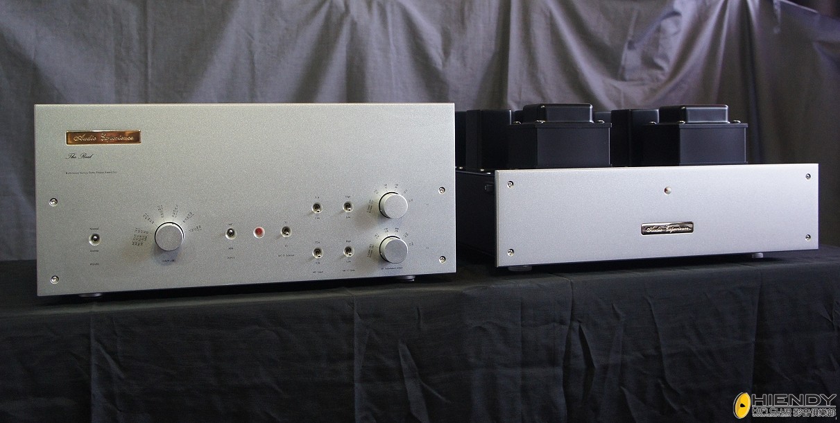

THE REAL phono MK2 旗艦唱放
經過2年半的究發,THE REAL phono MK2終於完成.
聲音和功能都超越前作(無論是4件式THE REAL phono 或 2件式的THE REAL-TU phono).
全新設計的放大線, 大幅減小使用交連電容, 改用直接交連, 失真率和對輸入容許度亦改進了, 聲音得到實質的大進步.
MK2電源供應部份比前作4件式THE REAL phono再加強一倍, 前作1個電源供應只有1組高壓穩壓供電, MK2的電源供應部份內有4組高壓穩壓供電分別獨立供應左右input和output級.
內置2組MC step-up 牛, 各有獨立阻抗選擇制.
主Gain制配合雙再加low/high gain 有6×5= 30個變化.
Features
New input stage 6DJ8 tube direct coupling to 6C45 tube driver line transformer in input stage.
5687WB with Hasimoto line transformer in output stage.
V-Cap CuTF coupling cap at output stage.
Vishay VTA55 , /Dale RN55 , AMRA Resistors
LCR network use Hasimoto Inductive
Hasimoto HM-7 MC step-up transformer.
Jensen JT-347-AXT MC step-up transformer.
Four pair MC input, One pair MM input.
Output with both XLR and RCA
Phase select switch Normal / Inverse
External power supply
Two Hasimoto power transformer , Eight Hasimoto Choke , four EZ80 tube at HVB+ power supply
Two MC impedance select switch with 6 position for T1 and T2 MC step-up transformer.
Gain select switch with 6 position gain
Specifications:
Controls.
Power Supply : Power On/Of .
Main Unit :
Phase Normal / Inverse , Gain select.
MC/MM select, T1 / T2 MC-step transformer select, T1A / T1B MC input select, T2A / T2B MC input select.
T1 MC Gain High/Low select,  T2 MC Gain High/Low select,
T1 MC impedance select, T2 MC impedance select.
Output :  1 pair Main XLR , 1pair Main RCA.
Input : T1A MC input , T1B MC input  , T2A MC input ,  T2B MC input,  MM input . ( all RCA ).
Output Impedance :
600 ohms ( XLR and RCA same ) , 600 ohms minimum load.
Frequency Response: +/- 0. 2dB 20Hz to 20KHz , RIAA equalized
Input Impedance:
T1
MC low gain:
520 ohm , 350 ohm , 200 ohm , 100ohm , 75 ohm , 50 ohm
MC high gain:
133 ohm , 90 ohm , 52 ohm ,  30 ohm ,  20 ohm , 10 ohm
T2
MC low gain:
2K5 ohm , 1K5 ohm , 730 ohm , 440 ohm , 290 ohm , 190 ohm
MC high gain:
1k1 ohm , 650 ohm , 320 ohm ,  220 ohm ,  130 ohm , 83 ohm
MM is 47K / 100P ( the capacitance impedance can change by module )
Gain:
1 is MM 45dB , MC-T2-low 62dB , MC-T2-High 65dB , MC-T1-Low 68.5dB , MC-T1-high 74.5dB
2 is MM 44dB , MC-T2-low 61dB , MC-T2-High 64dB , MC-T1-Low 67.5dB , MC-T1-high 73.5dB
3 is MM 43dB , MC-T2-low 60dB , MC-T2-High 63dB , MC-T1-Low 66.5dB , MC-T1-high 72.5dB
4 is MM 41.5dB , MC-T2-low 58.1dB , MC-T2-High 61.5dB , MC-T1-Low 65dB , MC-T1-high 71dB
5 is MM 40dB , MC-T2-low 57dB , MC-T2-High 60dB , MC-T1-Low 63.5dB , MC-T1-high 69.5dB
6 is MM 37dB , MC-T2-low 54dB , MC-T2-High 57dB , MC-T1-Low 60.5dB , MC-T1-high 66.5dB
Noise: MM 93dB (shorted input) , MC 92dB (shorted input).
signal-to-noise ratio, below 1 Volts RMS output,  A weighted
Phase Mode : Normal / Inverse.
Max input : MM 90mV , MC 9mV
Distortion: Less than 0.16% at 2V RMS 1kHz output.
Tube Compliment : 6DJ8 x2,  6C45 x2 , 5687WB x2, EZ80 x4.
Dimension:
Main unit , 455mm x 350mm x 210mm (W x D x H)
Power Supply ,455mm x 410mm x 210mm (W x D x H)
Total Weight: 35kg
Power Source: 110-127  , 220 – 240V,50/60Hz for order.
