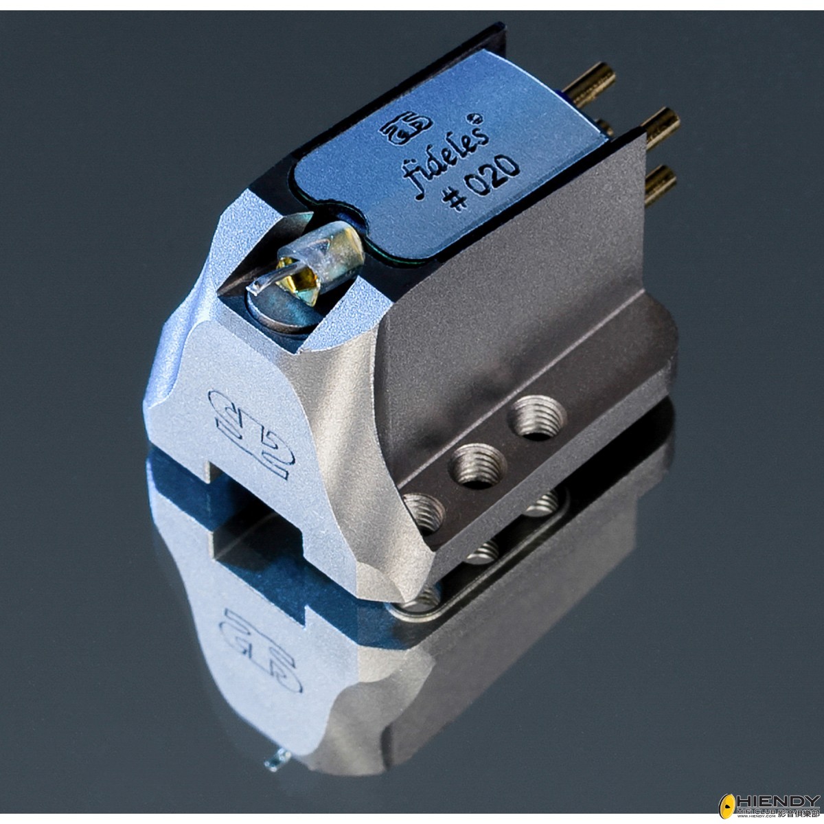

德國acoustical systems 推出空前實惠唱頭 Fideles.  Fideles 拉丁語代表忠誠,也是設計司兼老板Mr. Dietrich Brakemeier在設計Fideles的設計理念.  Fideles 著重音樂味濃,富色彩同時亦不失動態和分析力.
Fideles以MI(動鐵)為驅動模式, 配合AS引以自豪的 Titanium Timet 1100 鈦金唱頭外殼, 能有效發揮MI頭的魅力.  唱放一般在35db-50db增益就能搭配得宜. 跟其他AS唱頭一樣, Fideles機身有3組鑼絲孔,確保配搭任何唱臂都可調整到所須超距(overhang).
the fideles – the technical specifications
frequency response                        18 Hz – 25 kHz +/- 2 dB
channel balance                             within 0.8dB @ 1kHz
channel separation                         better than 25dB @ 1kHz
output voltage                               5.5 mV, 1kHz @ 5 cm/sec
static compliance                           35 mm/N
dynamic compliance @ 9-10 Hz       17 mm/N
vertical tracking angle                     22°
stylus                                            true elliptical 7µ x 2.5µ
factory-replaceable
recommended load resistance          47 -100 kΩ
recommended load capacitance       phono cable + 0-max 200pF
cartridge body mass                       10.5 g
recommended tracking force           17 mN to 18 mN
