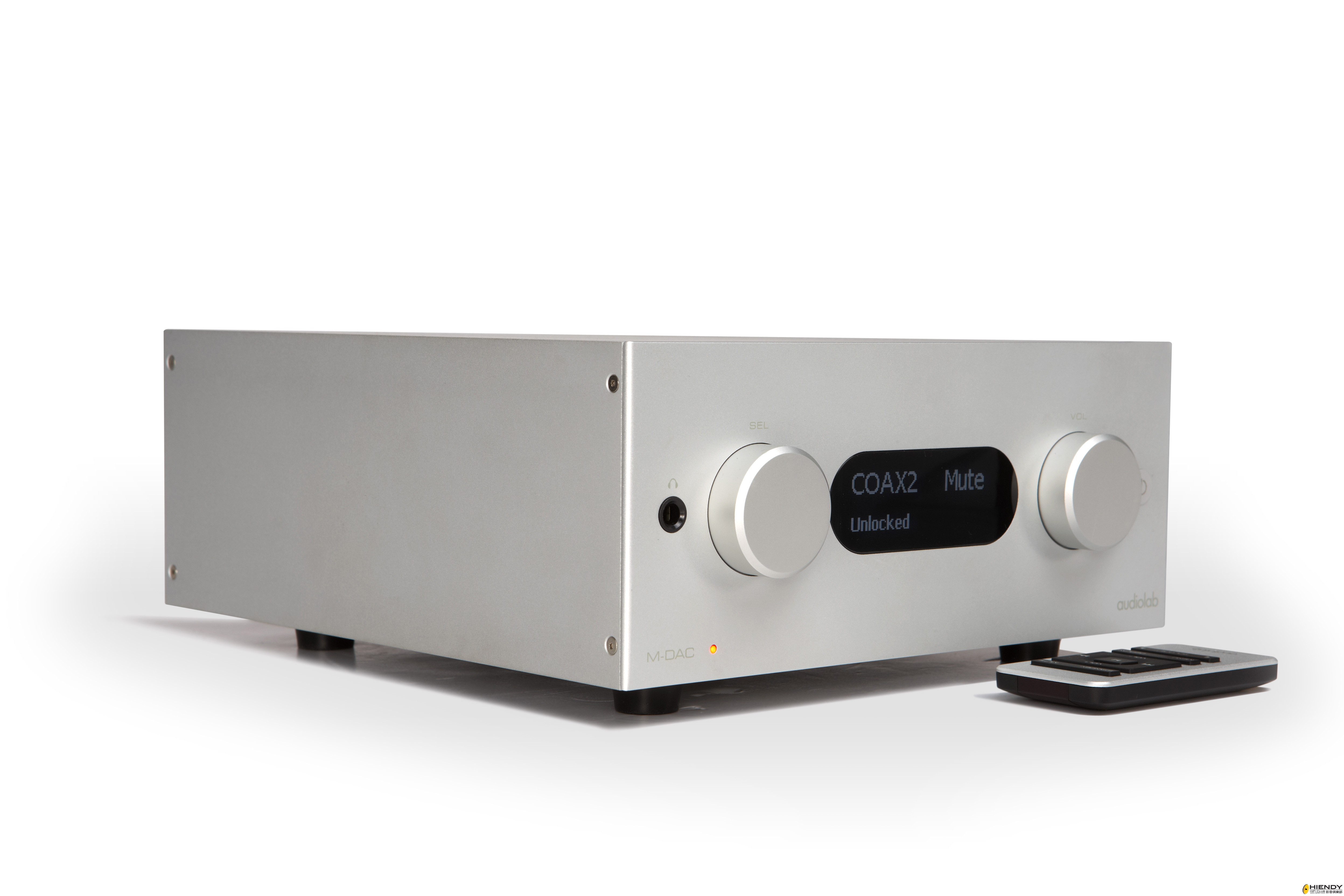

M-DAC+ enhances the performance of the original M-DAC in so many ways. Now capable of 32 bit
/ 384kHz resolution for the USB input and 24-bit /192kHz for coaxial and optical inputs, M-DAC+
can also link directly to your apple devices to make the most of all your stored music via an A-type
USB cable.
If you’re a fan of DSD audio, M-DAC+ even encompasses that format too. And with its choice of 4
different decoding filters for DSD audio and 7 filters for PCM audio, you can select the right filter
to get the best performance from each source right from the comfort of your listening seat.
In addition, Audiolab’s engineers have dug into the depths of the digital decoding capabilities of
the Sabre 32-bit DAC that is at the heart of M-DAC+, extracting every ounce of musical detail and
displaying it in a stunningly realistic, rich and believable 3D acoustic.
Versatile in capability and alluring in performance, M-DAC+ will continue to delight you for many
years to come.
